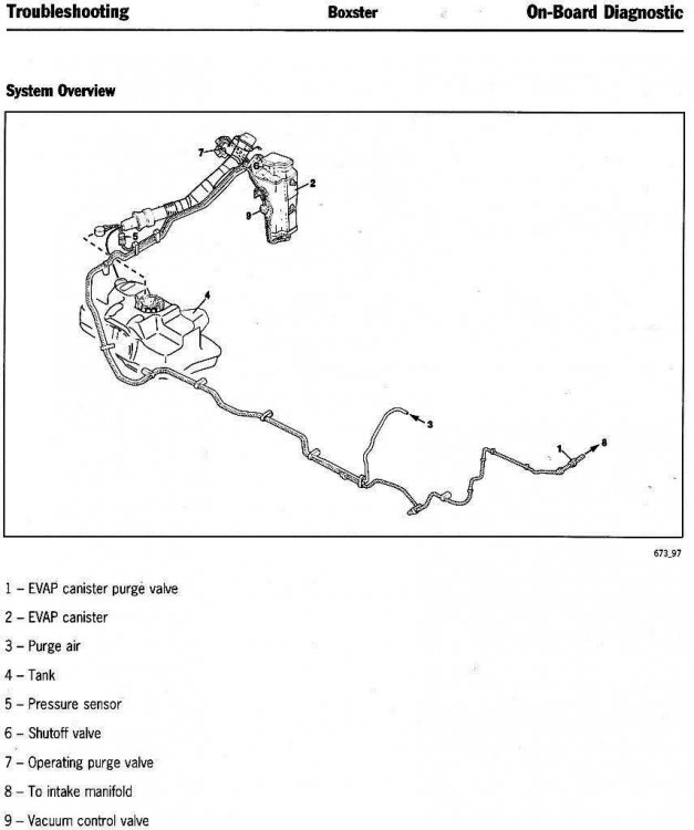

I have the same P0446 problem. Want to replace Evap Cannister purge value in page 1. The diagram shows it as part #1. Can somebody please tell me where it is in the car? If there is a picture associated with it, that would be great too.
I have no clue where to look. the EVAP cannister housing is inside the wheel well I know. But part #1 which is at the other end going to intake manifold or something is what I am looking for.
The purge valve is under the intake manifold runners, as noted earlier in this tread.  Item #20 in this diagram:

LOREN.. I have the same 99 996 as yours. I am wondering should I be able to blow each way through the line and blue valve in your photo? It is called the Vacuum Control Valve #9 in the diagram above.  I am getting po446. When the line is disconnected top and bottom and taken from the canister. I can blow each way through the line passed the blue vacuum control valve. No electrics attached to the line. Should I be able to do this? I expected it to be like a 'one way' valve but mine is not. That fact may be why I get the 446 codde The next time you are in there, could youy please blow through the line for me and let me know the outcome. Thanks in advance.
