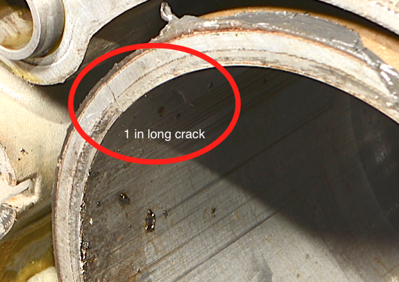

Well Gents.............Took the heads off & its much worse than expected. A dropped valve seat causing extensive damage & a cracked cylinder liner. Looks like a chunk is cracked & ready to fall off. Im pretty sure i can save the head & have looked at sleeve options available at L&N engineering though exellent in quality with an great reputation, they are too rich for my blood.
Are there any sources for the traditional steel cyninder liners pref in CA? Thank you ion advance.

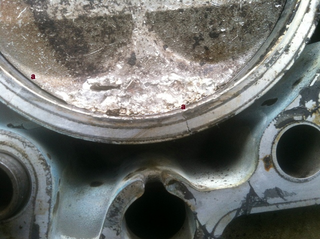

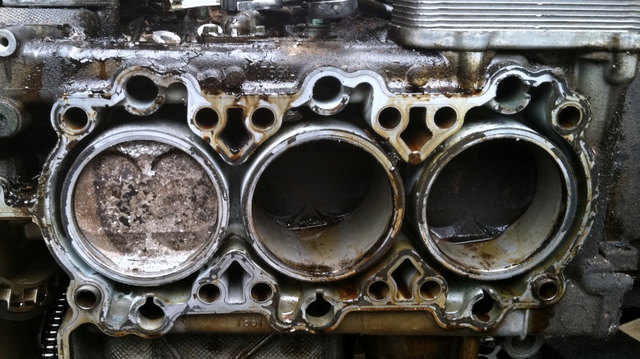

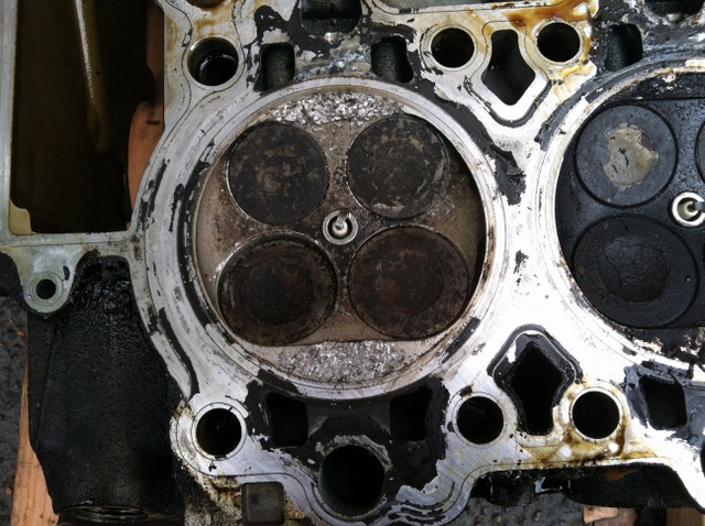

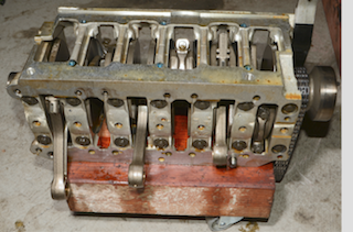

Interesting. There are more threads on cracked valve seating ring issue.... Also an '02, and also Cyl 4 & liner crack as a consequence. My #4 piston rings are  seized, and likely the additional radial pressure from piston/ring initiated the  sleeve to crack . However, interestingly, there are no signs of a broken seating on the #1 cylinder , but I also see that there was some hard debris in the chamber (see picture of the damaged #1&#4 domes/pistons) , causing piston and head to be deformed - yet the rings are still ok, and piston would likely work again. The real question to me here is where the debris in Cyl # 1 could have originated ?  Can a parts of the broken intake valve seat from #4 somehow be transported to  #1 cylinder ?? How likely it is that the damage may have been primarily triggered by sth. other  than just a valve seat quality issue for this model year???  So far I thoroughly sonic'ed and inspected 99% engine components w/o finding any obvious damage/emanating hard debris material. The crank cradle assembly is the last item In question here, but which I am hesitant to dismantle if the likely hood of the root cause there is low. All rods move smoothly and show no bends or other damage). I just wanted to clean the cradle from the oil/coolant mix and just re-use.  Otherwise , it looks like, likely getting  engine casing , one head and at least one piston replaced  is what will likely  get this baby running again.  BTW- if sb. has a 3.6l casing in good used cond. for sale - please let me know. Thanks.
