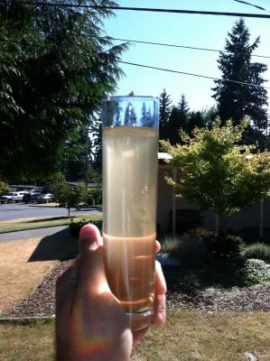

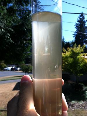

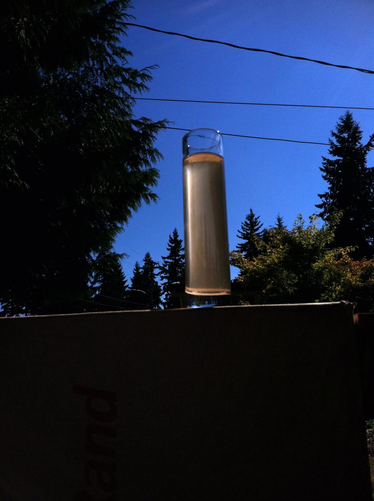

Looks like I have the dreaded intermix. See photos...
99 C2. 145000 miles.
Replaced water pump 2000 miles ago.
Murky coolant. Drained, run and filled 3 times with distilled. Color wont change. Lots of little pieces of black plastic too. I assume from the old impeller. Never got to see what it looked like, so I dont know how bad the impeller came apart, or if it did at all.

I don't see an intermix, I see cloudy water. Intermix between coolant and oil gives you something that looks like lumpy hot chocolate, usually with drops of oil floating about.
Suggest recharging the cooling system with distilled water and a cooling system cleaner, run it for a bit, drain it and then flush it at least twice with clear water. I'll bet the second water flush comes out clear.......

Thats the exact step Im at. Used two small jugs of flushing cleaner as recommended. And Im on my 3rd flush of distilled. The color is exactly the same as the first drain. The water in that flask has a very slight sheen to it also. I think Im catching an intermix issue right at the very beginning. No?
If you are having an intermix issue, it has to be very slight. Two suggestions to contemplate: (1) Have the cooling system pressure tested, even very small leaks show up in these simple tests. (2) Get a small bottle of UV dye for engine oil (Uview, the people that make the Porsche vacuum filling system sell it) and add it to your oil. Run the car for a day with just water in the system, and then pull a sample of the coolant and check it with a UV light to see if it glows. If it is a very small oil transfer, it will still light right up as the dye is very sensitive.

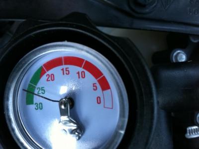

I have the uview vacuum filler. I can vacuum test it correct? Or is the pressure test better?

Either pressure or vacuum will work; take the Uview unit vacuum down as low as you can get it and then cut off the air flow and see if it will hold that vacuum level for at least 30 min to an hour. If it does, you probably don't have a leak. You may want to put a small hunk of masking tape on the Uview's dial as a reference point during the test.

You won't know for sure until you properly test but I don't think you have intermix. Intermix looks like gooey pancake batter as JPF stated. You just have cloudy water. No way to tell for sure until you do a proper test but I don't think it's a slamdunk you have intermix.

Your leak test looks good; I would tend to agree that the system is tight.
Having done a couple clean outs after non fatal intermix (oil cooler failures), it takes a lot of time, system cleaner, and hot water to clean out a system properly. You may just be seeing crud from the cooling system because someone used the wrong type of coolant at one time and the system is mucked up, or the car had an earlier non fatal intermix that is still coming out.
The UV dye will tell the story, if it does not show up in the coolant, there is no intermix.

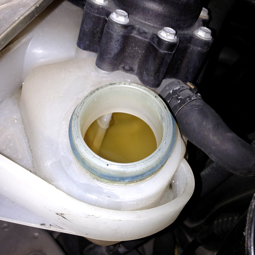

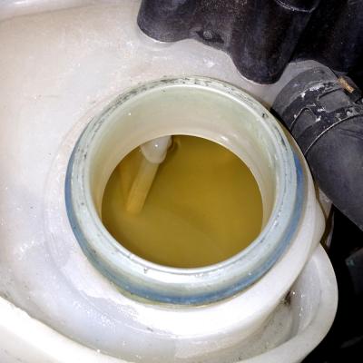

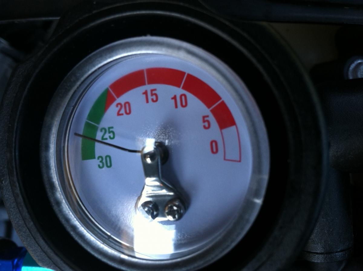

Besides the UV dye test (I called the local dealer and they had never heard of such a thing, nor the largest auto parts store), is there anything else I can do to determine if what I am seeing on my car is intermix? I don't have the milk chocolate thick goo as others have posted, but it is also not pink or green as standard Porsche coolants are. Reason why I am asking this is because of some occasional puffs of white smoke on initial startup after the car sits for a while, but only comes from the passenger side muffler. I thought it was AOS, but removing the oil filler cap was as easy to remove as if the engine was not running, all I got was some wind noise (breather/sucking air in) and a very slight (almost minimal) change in RPM (definitely not rough idling). Here is what my expansion tank looks like:
First of all, several companies make the cooling system UV dyes, including Airlift (see below), who makes the Porsche vacuum coolant refilling system:
Secondly, you definitely have the signs of an intermix issue in that tank. From your description of the exhaust smoke, you may have a cracked head.

While an oil cooler is always a possibility for an intermix issue, one element in this case points in a different direction: Puffs of white smoke from one bank after sitting for a bit. That sounds more like some coolant getting into the combustion chamber on one or more cylinders; I know of no way an oil cooler can fail and do that.
As he will be pulling the plugs in that bank to do a leak down anyway, I'd be looking for one or more plug that looks "steam cleaned", which would be a give away for a coolant drip. If this is found, you could bore scope the cylinder for more confirmation, but one or more clean plugs and a leak down should tell you where you are.
The crack I had in my head, at the inner exhaust valve spring seat on cylinder #1, which is basically the same place on the casting as cylinder #6, is one of the most common. And it will not show up on either a compression test or a leak down test, that s unless it has gone much farther than mine or most of the cracks at that location that I have seen. These cracks don't involve the cylinder compression areas. A cracked sleeve will. The crack I had just let oil and coolant move between the oil system and the cooling system. I had extensive intermix in both directions. When running ther is oil pressure that can force oil through the crack into the cooling system. Then when the engine is hot and turned off the cooling system is pressurized and coolant can be forced through the crack into the oil system.

Update: took the car to the local dealer and the shop manager took a look at the expansion tank and he claims it is not intermix and most likely it is that the PO used some non Porsche coolant. He said this after looking at the coolant expansion tank and smelling it, he says their is no oil residue at all (I agree, no oil upon visual and tactile inspection). Car will be vacuum flushed and pressure tested on Tuesday. He also claims that it is not a cracked head as the temps do not rise quickly and the car runs fine when warm. He claims that the white smoke is from when they recently overfilled it with oil. I checked the oil level last night, using the dipstick, and it is in fact still overfilled as confirmed by the dash oil level measurement (all bars lit).
Of note, the huge puff of white smoke was one time only, then the other two times when smoke came out, it was 1/10 of the first large puff. He claims that this is further proof that it is excess oil from the overfill being burnt. I am keeping fingers crossed that the cooling system holds pressure (I will be there to visually confirm the results...) and that the new clean coolant remains that way for a very long time.

Update: took the car to the local dealer and the shop manager took a look at the expansion tank and he claims it is not intermix and most likely it is that the PO used some non Porsche coolant. He said this after looking at the coolant expansion tank and smelling it, he says their is no oil residue at all (I agree, no oil upon visual and tactile inspection). Car will be vacuum flushed and pressure tested on Tuesday. He also claims that it is not a cracked head as the temps do not rise quickly and the car runs fine when warm. He claims that the white smoke is from when they recently overfilled it with oil. I checked the oil level last night, using the dipstick, and it is in fact still overfilled as confirmed by the dash oil level measurement (all bars lit).Of note, the huge puff of white smoke was one time only, then the other two times when smoke came out, it was 1/10 of the first large puff. He claims that this is further proof that it is excess oil from the overfill being burnt. I am keeping fingers crossed that the cooling system holds pressure (I will be there to visually confirm the results...) and that the new clean coolant remains that way for a very long time.I'd like to take a minute to thank you all for your replies and guidance. Will report back next week after coolant flush and pressure test.
I sincerely hope I'm wrong for your sake, but sorry, but this does not look like "the wrong coolant", it looks like an emulsion mix:
Which this definitely is:
We have also seen cracked heads that never over heated.
