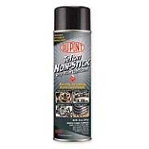

A better suggestion: DuPont spray dry teflon coating:
Cost about $8 a can, sold by everyone from Amazon to Lowes. Leaves a true Teflon coating that does not attract dirt and does not bother plastic parts. We even use this stuff on sticky starter Bendix drives, works like a charm.
