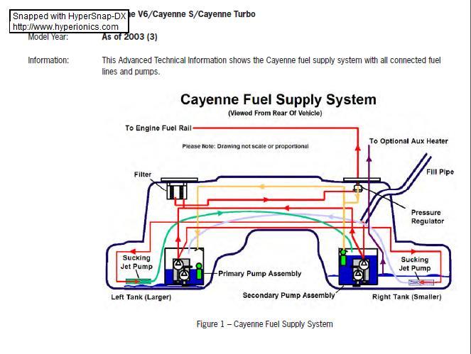

Attached is a diagram I found helpful in understanding the fuel system plumbing:
