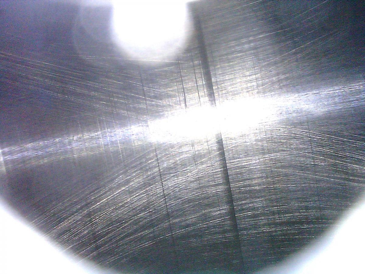

Are this line in circle, or are they from top to the bottom of the cylinder? Which side of picture is top of the cylinder?
It is really hard to see from these pictures.
If you have lines from up to the bottom of the cylinder it is scored, if they are in circle, they could be visible lines from honing.

These lines are horizontal as yo can see they curve on the ends to match the cylinder round shape.
this is my opinion.
Any body correct me if I am wrong
If they are just horizontal, then this are curve form cylinder honing. which is normal.
If you have chance make a video with sound, maybe will be easy to diagnose.
Here is a example picture how should scoring look like(horizontal lines are normal, vertical are scoring):
post-84890-0-56930000-1361794053_thumb.j
Strange, this really is sound of scored cylinder wall. Try to get better scope, to make picture with better quality. It's possibly, that we don't see scoring in your pictures. Did you do a compression test?

From my experiences, not porsche, but other engines, there was always some difference comparing to other cylinders. In some cases was difference more in some less, depending on how much damage has scoring left.
