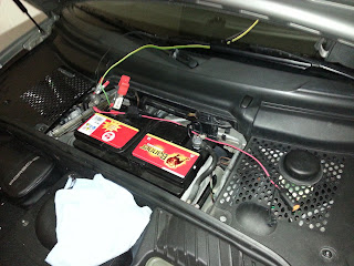

I have an interesting battery drain. I noticed that when I leave my car stationary for two weeks, it's enough to drain the battery. I Installed a CTEK Battery health indicator and noticed that it's rarely ever green.
For those of you interested: the Ctek Health Indicator uses 2 mA.So today I started my investigation with a multimeter. I pulled all lamps (trunk, glove box, left and right door and made sure no other lights are on and waited till the speedo was off.

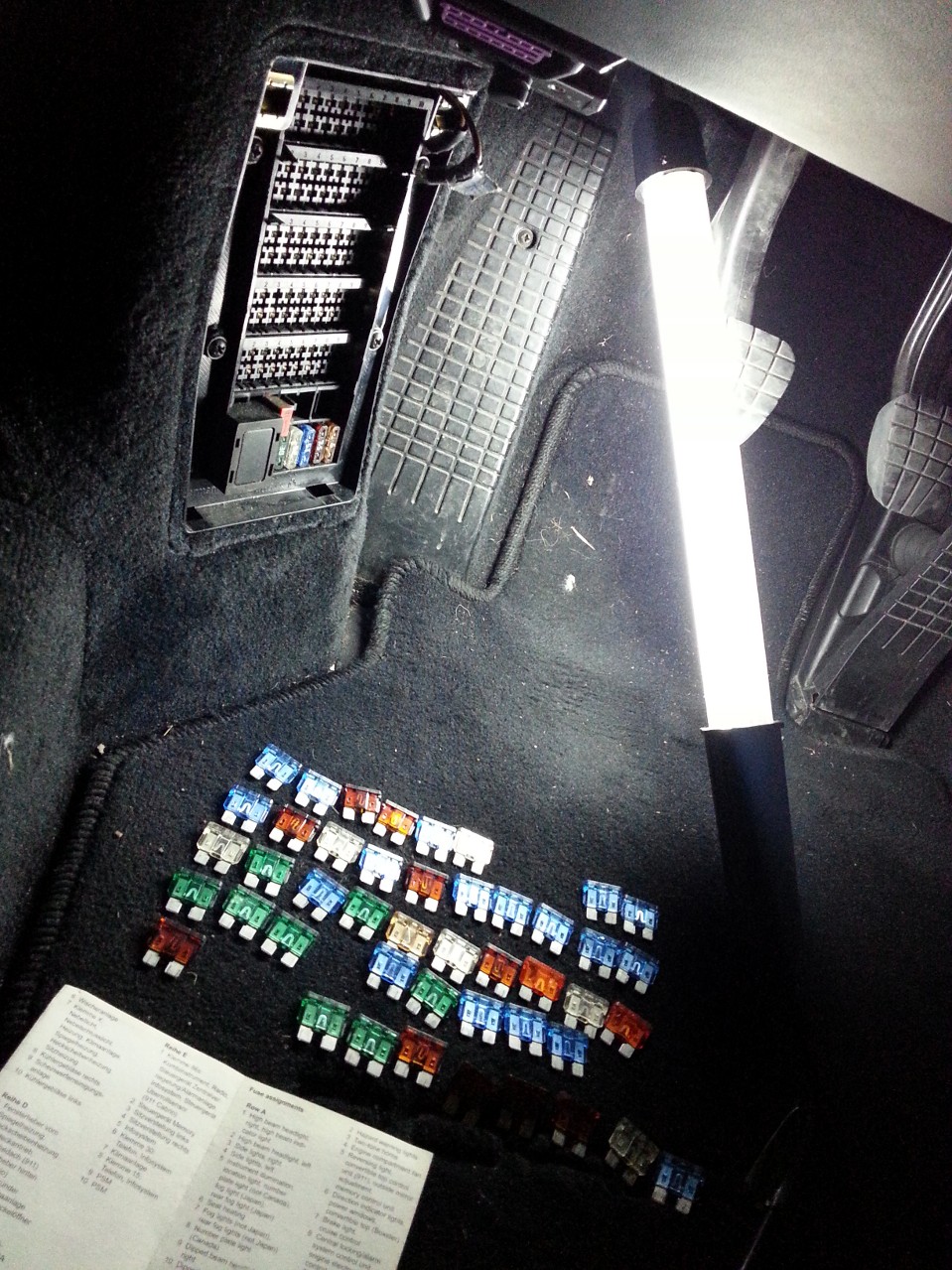

B1 pulled 167mA (Cluster Tiptronic, Diganosis and Power Top)
C3 pulled 123mA (CU Alarm System, Central Locking, Power Window)
D1 pulled 103mA (Power Window)
D8 pulled ended at 100mA (Radiator Fan 2)
So even after all fuses pulled I have still double the standby current left that it should have. At this point I have no idea where to look for as I have no accessory installed that are not going through the fuse box. The different accessories I have all end up in one fuse that I take power from (seat fuse).

Thanks Richard - very good list. But still my question: with all these fuses pulled (relating to all these consumtions listed in the document) what is still draining the battery i.e. which parts are not controlled in that fuse box?
