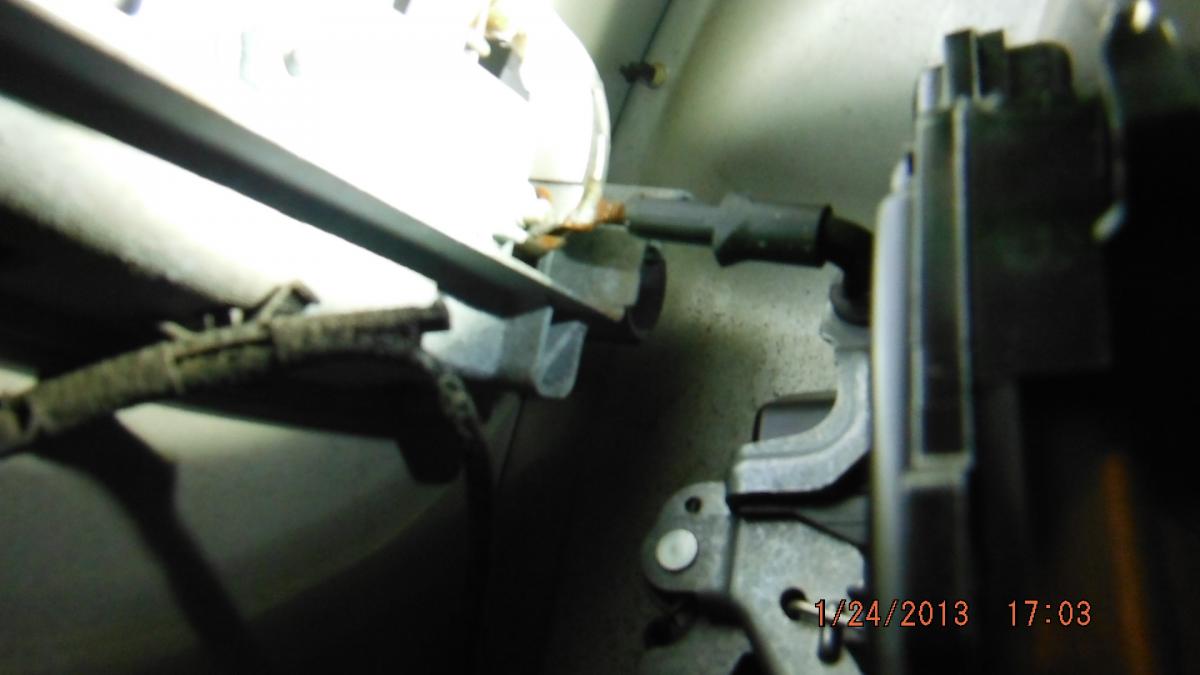

The link between the latch and the handle (see picture) inside the door is a sliding piece of plastic, which once slid towards the latch, allow the handle link in the form of a rod to squeeze through a slit on top of the small cylinder where the slider was. Neat contraption!
The electrical connector to the latch is a typical PCar connector which unlatches just like the MAF connector by pressing a tab forcefully to lift off from a boss on the male part ... don't you love those. Bonne chance!
post-81781-0-26760000-1369778837_thumb.j
