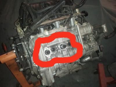

It looks like the intake manifold looks quite a bit different from the stock 2.5.Am I right? could a quick glance at the manifold give me a pretty good Idea weather I have the real thing.I have no reason to doubt this guy but he may be as naive as I am.
Any chance you have some photo editing software you could mark your 1st pic up with a couple of arrows?

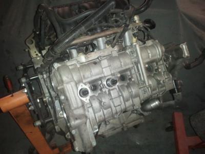

The two dark protrusions in the cam cover along the line of the spark plug openings are the give away, a VarioCam system would have one, VarioCam Plus would have two (the second is for the variable valve lift function on the 3.6):
The 3.6 only appeared in the 996 style body, which has a taller engine compartment, so a taller manifold is not a problem; but on the Boxster, the engine cover would hit it, so you need to lower the engine slightly.
Beautiful, thank you.

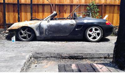

I just want to replace my burned up super 2.5 with something durable and fast-ish.stock 200hp was cute, 275hp was perfect, 300+ would be lots of fun. I didn't feel the low end torque I was use to but I didn't push it. if This 3.6 is legit, I guess I'll just need to learn to drive it.

Ok, here's some picks the seller sent me, do they mean anything as to weather this motor is a true factory 3.6L.All input is greatly appreciated.
