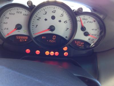

Lastly, when I picked it up the instrument cluster went a little crazy, until we disconnected and reconnected the battery. The mechanics had also never seen anything like this either. Enjoy the picture of the highest milage Boxster ever. I only grabbed a picture after they switched to miles, when it was in km, it was reading 999,999. Which I think may have affected resale value.

post-18988-0-75505200-1382558532_thumb.j
