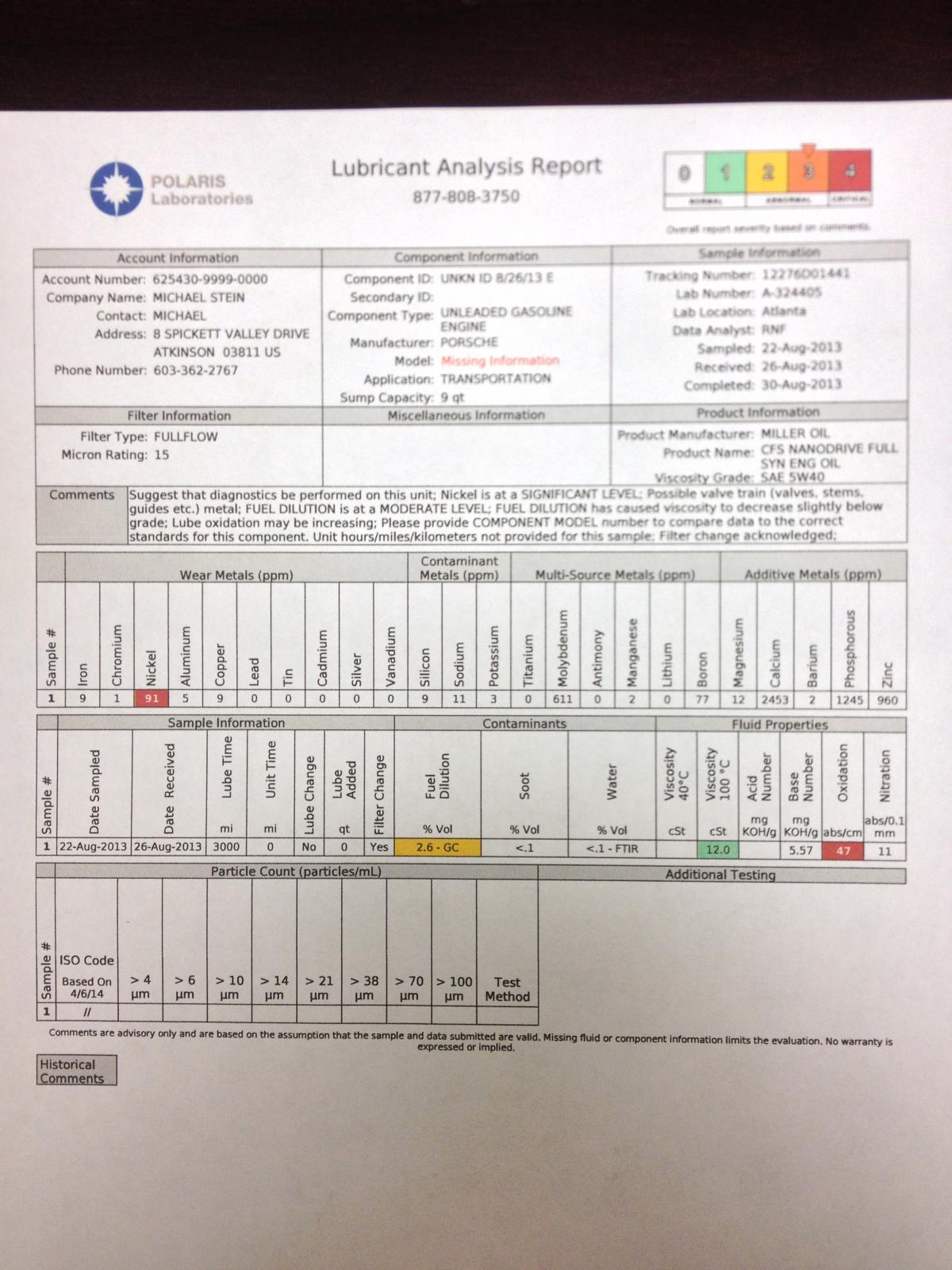

This is the first oil analysis report on my 06 C4S 6sp. I was concerned because the 2nd owner beat the ---- out of the car on the track. This sample was taken with 17,400 miles on the odo when the oil had 3000 miles on it. I started to freak when I saw the Nickel level. But in thinking about it, these cars have Lokasil cylinder liners. NO NICKEL. There may be nickel in some of the bearings alloyed to mostly.. Iron. Notice all the other wear metals including iron are just fine. Harry King from Performance Racing Oils spoke to Millers Oil about it and they said this was most definitely a lab error. What turns out to be the real problem is the fuel dilution!! Now, my office is only 3 miles from my house and I live in New Hampshire with cold Winters. The car does a lot of short cycle driving from cold, running rich, barely getting the oil up to operating temp.
The oxidation has nothing to do with the oil. It is the dissolved fuel. The viscosity is barely within range from the fuel dilution. As the oil becomes progressively diluted it looses viscosity. One wonders if the problem of scored cylinders has it's basis in this problem!! No way is this or any oil going to make it to 10,000 miles under these conditions. A real eye opener.
Check your oil at 3000 miles. If it is OK check it again at 6000 miles. If it is still OK then you are good to go to 10,000 miles under the conditions in which you drive. People who live in warmer climates and do not do short cycle driving will probably be just fine. People like me are going to have to change their oil more frequently or use a higher viscosity to start with.

When you say "I love reading UOA's", are you being facetious? To me, I could get this type of report back and not make any sense of it...
I am being serious. I do Blackstone UOA's for my engine oil and trans gear lube. One report give us very little, but over a few years, you can really start to see trends and feedback.
Edited by White987S
Yes White, In most cases, with wear metals it is the trends that mater unless you see a pile of wear metals to start with. Usually, if things are going south, you will pick up small amounts of wear metals which over time slowly increase. The percentage of the various metals depends on which bearing or wear surface is deteriorating. In aircraft engines they can tell exactly where the problem is. We have to guess. This lab needs to run more controls on its machines. I will try Blackstone the next time around.
However the fuel dilution is a problem right up front. Another few thousand miles and this oil's viscosity will be below grade. With the M97's habit of scoring cylinders that is the last thing I or any of us want. The usual explanation for cylinder 6 scoring is that it runs hotter than the others and it's oil jet may not be as strong. Those are just the conditions under which you do not want the oil's viscosity to drop. The perfect storm.
I agree. And it is most likely linked to your driving style. Short distance to the office. Also keep in mind, if you went on a long drive, and burnt off the fuel dilution from the oil, your oil level will drop a little. And you don't want to drop below the min level. So keep an eye on that too.

My problem was not the oil. It would have been good to go if it was not diluted with fuel. It does not matter what oil I use. Given the same circumstances the same thing will happen. Now, I let the car idle for 5 minutes on start up before driving off. Hopefully this will help. A $600/year oil habit I am definately not fond of.

This is fun!!. Dustin, There is a very important pattern in your sample. Iron, molybdenum and chromium are all high. Anyone here heard of Chromoly steel?? As in piston rings?? Your TBN is too low. Acids eat metal faster than anything. You do not want to run a TBN lower than 3. Your viscocity is also dropping but you do not have any fuel dilution which means your oil is deteriorating. If it were my car I would change oil brands and retest the oil at 5000 miles by dropping the oil filter. If the oil is OK then run it to 8000 miles. Post the results here.
0365kid Why no TBN?? That is perhaps the most important value in an otherwise healthy car. I would quiz Blackstone on this as it should have been done. As with Polaris I am not overly impressed with Blackstones analysis.

Yes, TBN stands for total base number and it is an indicator of your oils ability to neutralize acids which are a byproduct of combustion. As your oil ages the TBN will drop. At 3 it is time to change the oil. At 3000 miles my TBN was still above 5. Dustin's oil was below 2 at 8000 miles but different manufacturer's oils will differ depending on the additive package. On TBN alone I should have easily been able to run my oil to 6000 miles. Interestingly, Dustin should probably have changed his oil somewhere around 6000 miles. So much for Porsche's 10,000 mile oil change interval!!
Yeah, no more 8K oil changes...the TBN showed me that. Funny that Blackstone says anything below 1 is bad. I cut open my oil filter and found zero metal particles. I even ran a magnet through my oil and pulled almost nothing out. I think if piston rings were wearing out, or cylinder liner, etc, that I would have smoke on start and I would be burning oil. I'm not kidding when I say I didn't add a drop of oil in 8,000 miles, so I don't think anything is going on. I did change my oil brand, from Royal Purple XPR (this sample) to Miller's NanoDrive. Will change it at 6K this time and send off a sample. The Moly content doesn't bother me as I run a Tungsten Disulphide Nano additive too which I'm sure has some Moly in it. Yeah, I don't know how Porsche claims to get away with 15K oil changes. Does anybody have a sample of recommended Mobil 1 run to that distance?
The long oil changes are simply to cut oil utilization and maintenance cost. The no warm up deal which all the manufacturers now recommend is to cut fuel utilization. These guys are even doing this worse than stupid stop start deal! All of us know that there is no way this can be good for your car.
Like I said Dustin, I am not overly impressed with either company's analysis. It was Millers who reassured me that the nickel was just a lab error. You are right in that the moly is a multi source metal, the chromium and the iron are not and unfortunately, the three go together. In my profession we say "if it walks like a duck and talks like a duck, it is probably a duck."
Early on with a wear issue you only get microscopic particles which you will never see in your oil filter or on a magnet. This is long before your car will smoke or burn oil. That is why this is mandated by the FAA on all aircraft engines, the point being to pull the engine before it craps out. At Polaris Labs you can order a process called Analytical Ferrography on your next sample. This will tell you exactly what microscopic particles you have in your oil. This way you will know if the moly is an additive or not. I think it costs about $50.

Jl-c, water condensation may boil off because water molecules are polar. Fuel and oil are both non polar hydrocarbons. Once fuel is dissolved in the oil it will not boil off and the drop in viscosity is permanent. If you really want to know what is going on you have to have your oil analyzed. I'm sure there must be a lab in the UK but, you can always use an American lab. Polaris sends you your results online. You just establish an account with them and they will send you sample jars on demand.
In regards to fuel dilution it does not matter what brand of oil you use. The most important characteristics that are attributable to the oil are the TBN and the oil's ability to maintain its viscosity with age. I could not tell you which oil is better that is what the lab is for. Don't guess, know! Test the oil every 3000 miles or so and see what it does.
