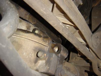

post-1098-1111210575_thumb.jpgI have just found what appears to be the first signs of an RMS leak on my 99c2, there are no spots of oil on the garage floor but the area where the engine and gearbox join has a greasy film covering a section about 2 inches by 4 inces. Looks like its been happening for a while as its a mixture of oil and road grime.
My car has done 19000 miles, I bought it new and it has not had any RMS work before.
Any suggestions on what to do now, its not dripping oil so do I just leave it until it gets worse or is the best course of action to get it replaced asap. The clutch is OK, no signs of slip.

Do not look under the car again and it won't effect you.  Many cars over time will show signs of oil biuldup.  It doesn't mean there is a leak.  Woory about it if you start loosing oil or see drops on the ground.

I would suggest to take the car in to the dealership and have them verify that it is not an potential RMS problem. If they say it's not such an issue you will be feeling better. If it turns out to be an RMS in the making you have sufficient time to start rattling the cages and get some agreement as to whom is going to cough up the money for the repair. The quicker you have the information on record at the dealer ship , the better.

If you want my opinion, just forget about it. Drive it and don't worry. If it's in warranty then get it replaced (even though that probably wont fix it). If it's out of warranty then sh1t happens. I am on my 7th RMS and it's still leaking albeit only 2 drips per month. But I just did a 2800 mile trip to Spain and back and never had a problem and didn't even have to top the oil up once. The drive was as stressful as can be for the car, 700 miles of it through totally empty Northern Spanish mountain roads with 23 other Porkers from PCGB. Believe me when I say, if my engine was going to blow up because of RMS problems it would have done so on that journey.

It's a while since I started this topic and since then it dos not appear to have become worse. I'm with you I plan to enjoy the car and fix it later if required. I took it to my local Porsche independant mechanic and he advised the same, said he has seen plenty much worse.
