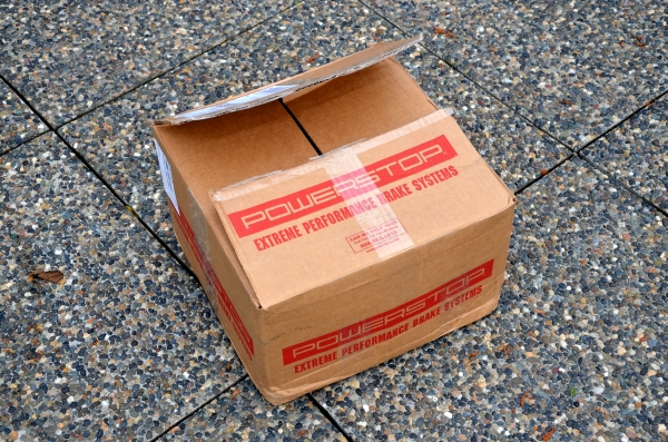

About 63 lbs according to shipping label.

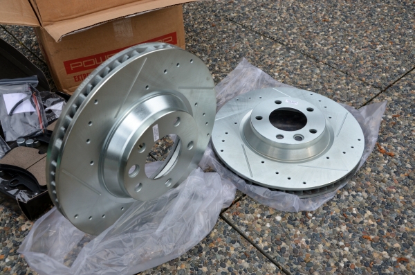

post-88071-0-79303700-1384027808_thumb.j

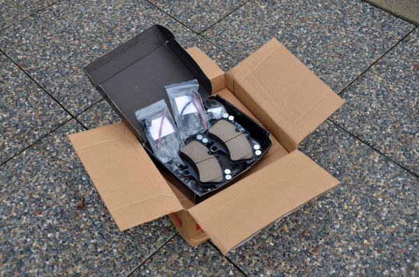

Box contains two rotors, set of ceramic pads and sensors
post-88071-0-62045000-1384027815_thumb.j
Right and left rotor indicated by a sticker on the rotor, or you can figure it out by the angle of the slot and/or drillings

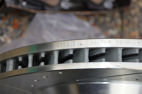

post-88071-0-47427300-1384029218_thumb.j

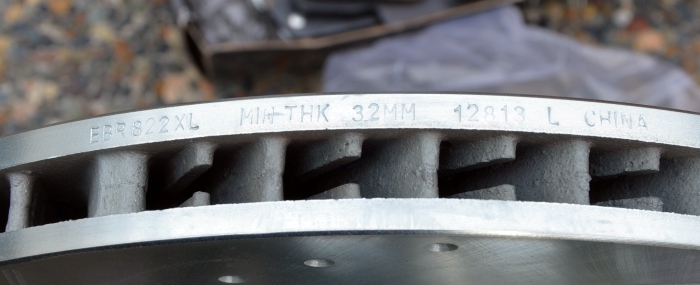

Stampings on the rim says "EBR"... hmmm.....

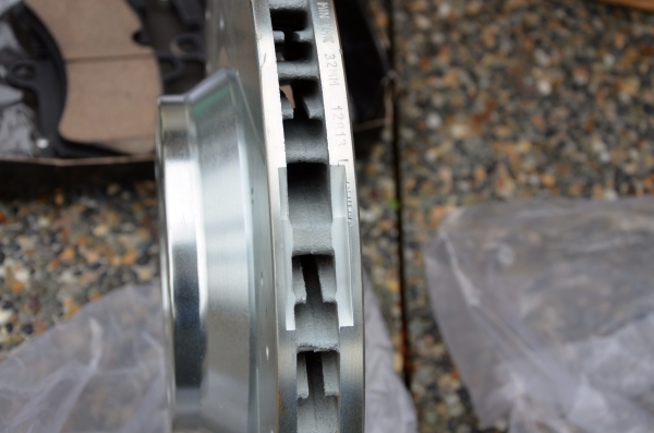

You can also see that the inside half is thicker than the outside half. Anyone know why?

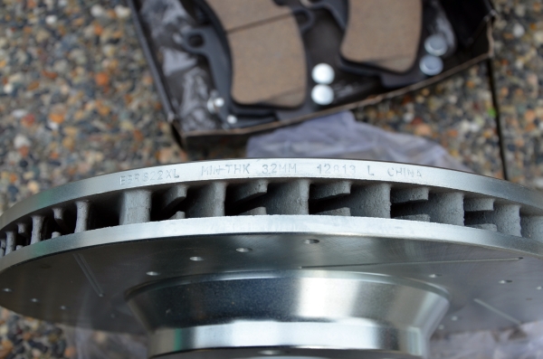

post-88071-0-93966200-1384029892_thumb.j
Stampings also say "China". Both Left and Right rotors have the same stampings. No indication of left or right. Both have the letter "L" on them.

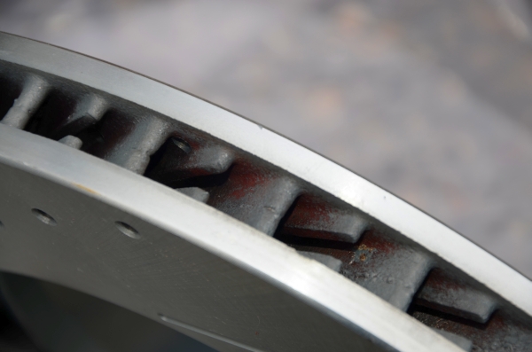

One rotor was showing rust on the inside. Looks like the grey (anti rust?) coating was sprayed on and on this rotor not as well done as the other one.

I'm not suprised these are from a chinese company.....again there are only a handful of rotor blank companies out there.....everyone buys from those companies and does "something" to them to make it their own.....similar for gasoline.
That machining "gouge" is not normal......remember, these come out of a casting....so unless something really F'ed up.....there would be somewhat of a tight tolerance around the castings being the same.......i would ask about that slot (pretty big chunk of material cut).
Also, there should be a left and right rotor.....the veins arc in the direction of rotation.....not sure how "required" that is, but OE type blanks are specific on the front.....even centric/stoptech brands.
Finally, the internal side is generally always thicker because that side will generally see high pad pressure....on single piston calipers the wear difference is even more noticeable....sometimes as much as 2x.

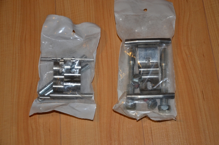

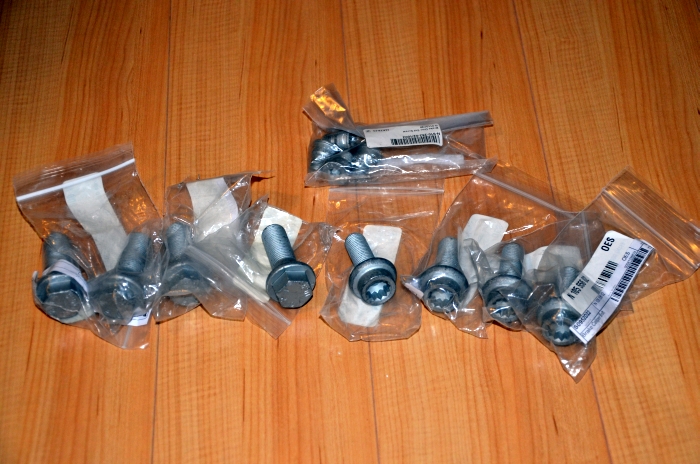

post-88071-0-97972300-1385798683_thumb.j
Caliper bolts, front and rear set plus disc set screw. I don't think I really need them... should just reuse the existing ones, any comments?
post-88071-0-98263600-1385798690_thumb.j
Hardware Kits are from Centric, one front set and one rear set.
i reused the caliper bolts and pad pins....simply because they are non stretch bolts and i didnt order replacements.
If you already bought them and cannot return them, then why not replace them? As for the pins....they will be a pain in the but to remove becasue they will have gunk all over them(see my DIY). Once you scrape enough off, you should be able to get them out....but clean new pins would be nice to reinstall.
But short answer, do it if you want, but don't feel compelled to do so

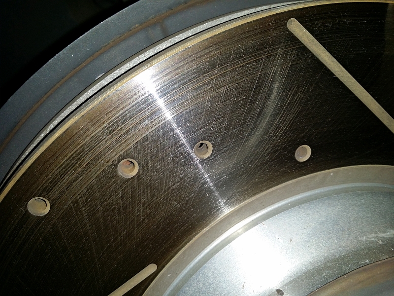

post-88071-0-93846400-1410839606_thumb.j
If that's a picture of the bedded rotor then you need to redo the bedding.  The challenge with slotted and drilled rotors is building heat into the rotor for a proper bedding....they are built to expel heat as quickly as possible.
The rotor clearly hasn't gone through a heat cycle and most likely has no/very spotty transfer layer.  If this is a pre-bed picture can you get us a picture of the rotor now?  You can tell a lot about the brake system by looking at the rotor.
The picture above is a brand new rotor prior to any use, which also means no bedding.
Here are pictures of the rotor after three beddings ( each maybe a month or two apart) and about 6 months of light everyday city use.

post-88071-0-69625900-1411096646_thumb.j
Passenger side rotor:
post-88071-0-64814600-1411096734_thumb.j
Obviously there is a problem with what I would call uneven contact/wear.  I do not know how to get rid of it, ie. make it wear evenly  or is it a defect of the pad or rotor itself.
Look forward to replys from the expert Forum members.  Thank you.  The only thing I can think of is I went too easy when bedding and should really "go at it".
So it's a little hard to tell from that photo but it looks like you might have gone a little easy during bedding, it looks like there is some areas of glazing.  It's sort of weird that you have uneven pad contact considering we have multiple piston calipers.  Anyways:
I'd go back out and really stick it to the pads......you will want to do many passes and get heat into them.  If the brakes aren't fading then you aren't getting heat into them.
By the end of my bedding, my pads are fading and generally there is a stink to the pads plus some smoke.  You should have a dullish finish all around.....and hopefully it will take care of that glazed zone you have.
