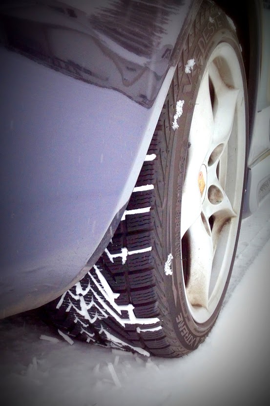

Hi,
I live in Metrowest, work in Boston and do the commute on Mass Pike every day - rain, sun, snow.
Makes the commute really worthwhile - listening to the engine.
Anyway - you don't need to buy N rated Porsche snow tires. ANY snow tire of the right size will do.
I went with Vredestein Wintertrac Xtreme for my dedicated winter setup with 18" wheels. It takes me 30 mins to do a switch over in my driveway.
I went to my local Direct Tire - and they price matched internet pricing for the Vredestein - but again - ANY WINTER TIRE that's the correct size will get you to the office and home on our roads. You're really splitting hairs in terms of performance between different tires.
For 2001 C4:
18" Recommended Front:225/40-18
18" Recommended Rear:265/35-18
post-49722-0-75313500-1386006458_thumb.j

Road Session, Problems Solved!! I am all set with an install appt for the Vredsteins at Direct Tire. That was a spectacular steer - MANY THANKS!!! Best part is they do free changeovers so I don't need to buy a second set of rims - so thats a $1k+ save to boot. PS I Don't get the bikini chick in a snow tire ad either, but I approve nonetheless.

Thanks to all for the input. Got the Vredestein Wintrac Extremes 225/40 18 265/35 18 today. Very pleased with dry handling and can't wait for some snow. Tried peeling out on wet pavement within the first 10 miles just to test traction and it held way better than I would have thought, especially given some of what I have read about them needing a 100 mile break in. Only bad news is that they said I have badly bent rims, but they don't seem too bad to me. A little vibration over 80, but I don't have $600 worth of motivation to get the rims straightened. at least not yet.
