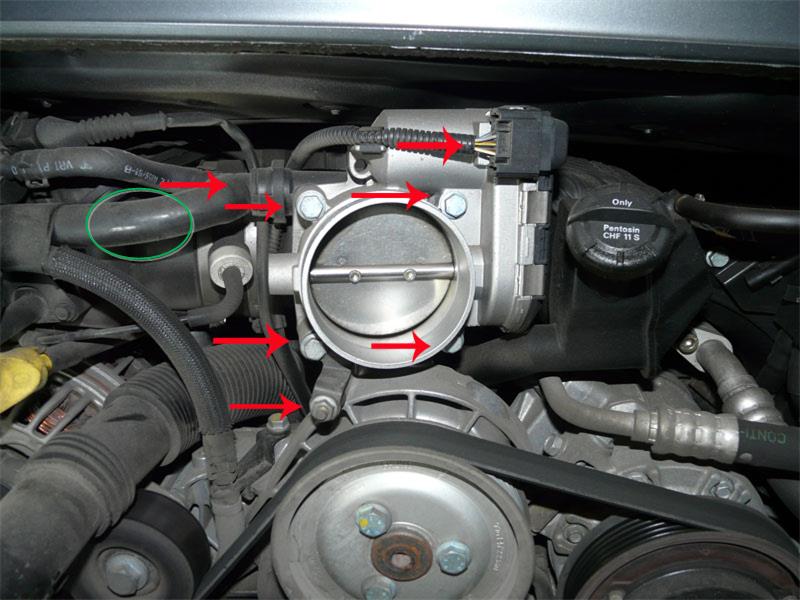

A few more ideas. I still suspect air leak after the MAF:
- After you drive around the block, what are your FRA and TRA values now?
- Disconnect your MAF completely and see if that helps idling
- Check oil filler tube for leak (oil cap should have some slight vacuum)
- Reconnect MAF and pinch this AOS hose circled in green (be careful not to damage it though) and see if idling improves. You can even monitor the misfire counts in Duametric acutal values in real time.

Ahsai, Thanks, I'll get to what you suggest tonight.
I think that the cause for the two error codes in post 72 above came from when you asked me to get the pre cat. Duramtric voltage without starting the car.
I had the air cleaner and MAF out of the car so I could take the manual voltage readings. Otherwise I don't think we would have seen any code.
I replaced everything before getting the last voltage readings you requested.
I'll clear everything before I try your above suggestions and see if we get any more error codes.
Thanks, Bob
