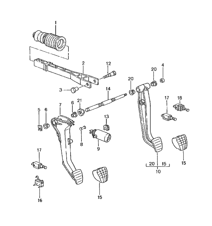

Been dealing with this for awhile, and just wanted some thoughts. Cruise control on the 01' 996tt doesn't turn on at all. Wont set the speed and won't light up the light on the dash. I am thinking that the culprit may be the red plastic clutch pedal switch with the plunger on it. The reason is because I am able to start the car without depressing the clutch. Before I buy a new one, just wanted to get a consensus from you guys, and or if you knew a way to test the switch first? Also I read that there are two switches for the clutch, but I couldn't seem to locate the "grey" colored one I read about?? Thanks for any help.

That made me believe that your clutch start lock switch #16 in JFP's diagram above is SHORTED inside. It's a micro switch with a metal lever on it when pushed (by the clutch pedal when depressed fully) the two terminal are shorted. But when the clutch pedal is not depressed, the two terminals should be open circuit. You can remove the two connectors on the switch and put an ohm meter on the terminals of the switch. Then push the clutch pedal all the way down to test. If you remove the two terminals, you should NOT be able to start the car either.

Pelican is the best. This was the exact photo I was going off of when I was looking for it. I was thinking the same thing, but I looked for it forever and there is nothing there, no switch. My car is a grey market car so maybe the european ones didn't come with it? I thought maybe it was from the moron previous owner removing it, but I am not seeing the wires for it either?

Having to depress the clutch to start the car is a North American trait mandated by the Feds to keep the unwary from driving through the back wall of their garage and into the family room because they forgot to depress the pedal. Been that way since the late 1960's. A grey market car would not have it.
