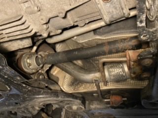

I have done my MY04 Cayenne-S replaced both sides with the aftermarket flex pipes ordered on Ebay. It is kind of impossible to DIY unless replacing with complete OEM part, since it requires professional welding that need twisting angle welding to flex pipes. I sent to a bodyshop friend in Montreal and charged me 7 hours labor.
Very poor design in exhaust system including to change O2 sensors. If you got chance to do the flex pipes job remember to change O2 sensors at the same time. Hope it helps; good luck!

I will be taking it to my local muffler shop to see if can cut out section and reweld without having to remove entire cat pipe.  Will keep updates.
Thank you
OMGOMGOMG.  My flex pipes were totally gone.. I had massive leaks on both sides.  Had read through all options and went to my local guy.  Cut off flex pipes and secondary cats.  2.5 inch stainless steel pipes with small flex pipe.  Completely different beast.  Price for parts and what dealer would charge is incomparable inked u can burn money without worry.
