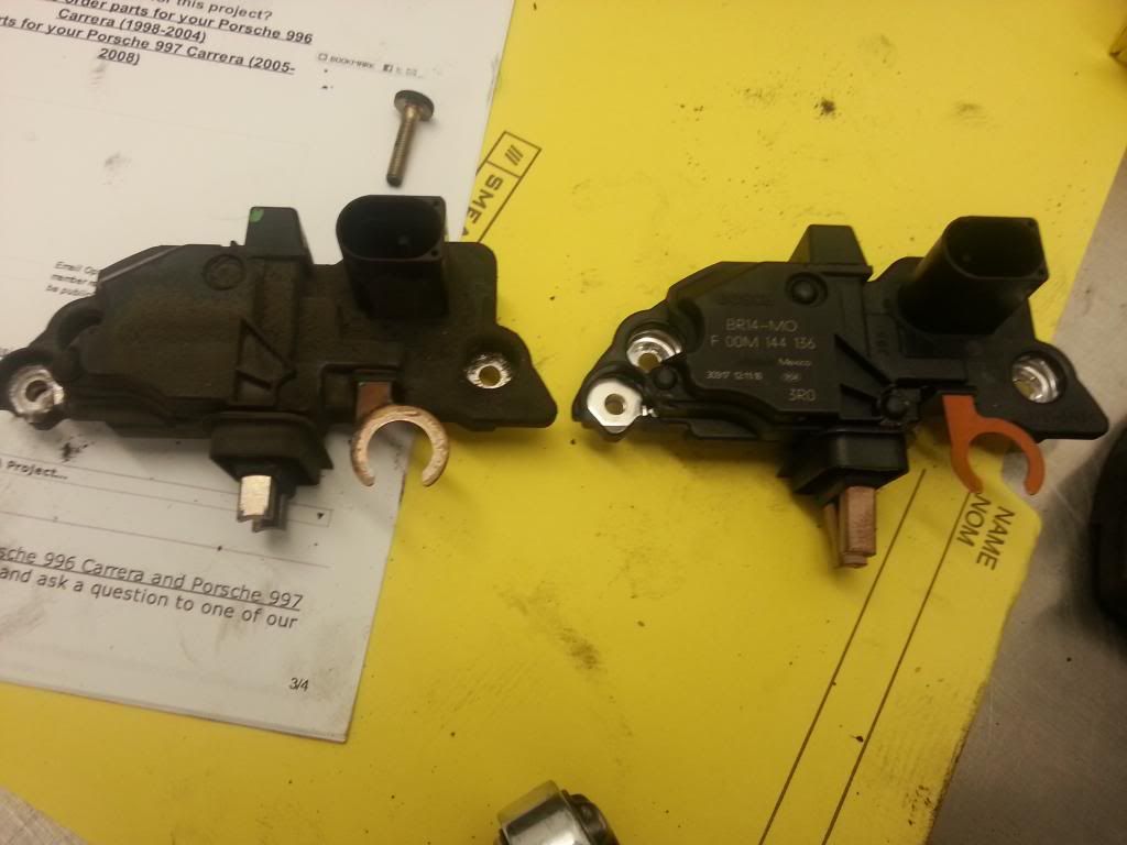

here is a side by side of the voltage regulator:
the picture doesnt really shown it but the new one had significantly more of the brushes than the old one.

just so you know, the load test they did on my alternator showed everything was fine, yet I still went and bought the part from pelican. $70 vs $500 (cost of oem alt) - no brainer to me. the alternator is super easy to get out. took me ( who never worked on a porsche) about an hour to get it out following the how to's on pelican.
swapped the regulator out, 're installed and havent had any issues since.
