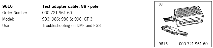

1. Connect special tool 9616 to wiring harness (DME control module connector).
2. Remove connector of actuator.
3. Connect ohmmeter to special tool 9616, pin 25, and connector, pin 2.
Display: 0 - 5 ohms
Display: 0 - 5 ohms

I will try it, mean while I'll start parts hunting a new Hall Sender, also is special tool 9616 a breakout box to the DME harness?
