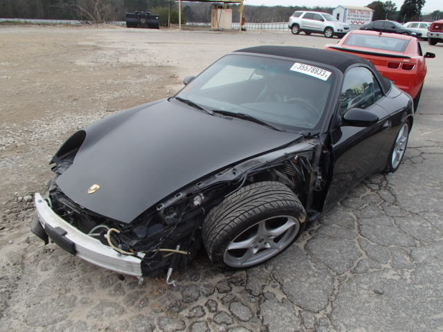

post-95801-0-24920100-1411849434_thumb.jpost-95801-0-35696400-1411849457.jpgNewbie here needs some help deciding what route to take. Here's the short version. I have jumped into the deep end of the pool before I learned to swim!
I have built wrecked cars for thirty years and have had older Porsche models in the past, just not newer water cooled. I first bought a 2000 wrecked C2 cab, 44k miles, minor left front damage.
Then I bought a 1999 Boxster, 51k miles to use as a donor.
Next, I got a call saying a local guy had a 2000 C2 cab, with 75k miles that had the motor out of it. (It is a MotorMeister victim). So, I got a smoking deal in it. Motor was tore down and on a pallet. No real failure evidence other than some metal on crank. Inspection or inventory of parts found missing cams, tensioners, etc.
Found a motor on Craigslist in Atlanta and purchased it. Owner said it was making a noise around 3-4k rpms. Filter has some very fine particles in it. Removed sump pan and only found a few small black plastic pieces. Looks to be timing chain tensioner, no metal of any sort. Kinda worried about just sticking it in the car.
Being a salvage dealer I found a 2001 C4 Coupe rollover car. Car is showing 209,000 miles. No motor history known. I went to the sale and actually started the car. It smoked, but ran. Purchased it and after getting it back to my shop it apparently hydraulic locked one of the cylinders. Removed all the spark plugs and drained one cylinder. Got the car running again and now it has water in the oil.
I have found a 2003 C2 Targa with damage, but after surfing the threads it looks like that swap might be a nightmare even having the whole car.
I have no Porsche mechanics in the local area, they are either dead or don't work on these models. The local dealer has two techs that are only trained on late model stuff and don't even have the necessary tools. I have tried to study up on the rebuild process and with the minimum necessary tools could probably handle the job of rebuild.
Sorry to get "long winded", just looking for some guidance, opinions, options or telling me how stupid I am. Go ahead, I can take it I'm a realist..............

I probably got the information a little overloaded. The black car in the picture runs. I bought the Boxster for a structure donor. The Boxster and 2000 996 are the same structure from the dash forward. I plan to cannibalize the Boxster for metal and suspension and sell the rest.
The other 996 I bought with the engine removed after being at Motor Meister. I bought another car and another engine but neither is road worthy right now. Since I buy salvage cars I have found some fair deals in 2002 and up cars. It looks like that would not be an easy swap due to electronics. When they went from five chain to three chain apparently they changed the electronics also.
A question I have is swapping in a three chain motor? Don't even think about it? Even if you have the whole car for a donor?
