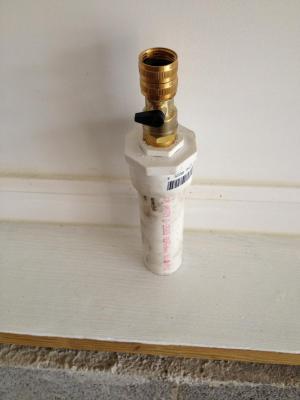

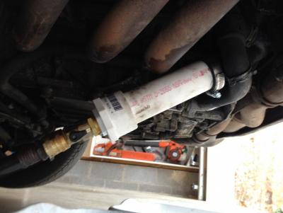

Thanks for all of the input. How do you go about backflushing the system? I can see using a hose and tap water, but do you follow that with a couple of "regular" flushes with distiller water?? If you are using a hose, where's the best place to open the system and what becomes the drain point?
You are going have to fabricate some bits to do this; on a Porsche, the water normally flows from the radiators towards the engine thermostat housing, so you want to disconnect the hose coming off the thermostat housing and make up some fittings to connect a hose into the car's hose.  Then remove the thermostat and housing assembly.  Now run the water into the hose, thru the front radiators, back to the water  pump and engine, and out the thermostat housing.  You want to be able to "throttle' the water pressure (house systems can have as much as 90 PSIG water pressure, the car is only rated for 20 PSIG and you can damage some very expensive parts if you over pressure the car).  We do this with a system we built that uses a pump to push water from a heated reservoir into the car at 20 PSIG, thru the system and back into the reservoir thru a stainless filtering screen to catch the bits.  You don't need to be that fancy, but I think you get an idea what is involved.

Since I was scared to death that some little piece of impeller was stuck in my engine, I cobbled together a tool for backflushing the coolant system:post-6798-0-80854600-1417032253_thumb.jppost-6798-0-74674900-1417032275_thumb.jp
After draining the coolant and backflushing until the water ran clear and tasted great, I am happy to report that no impeller pieces showed up in the drainage. Better safe than sorry. Thanks for the advice and information.
