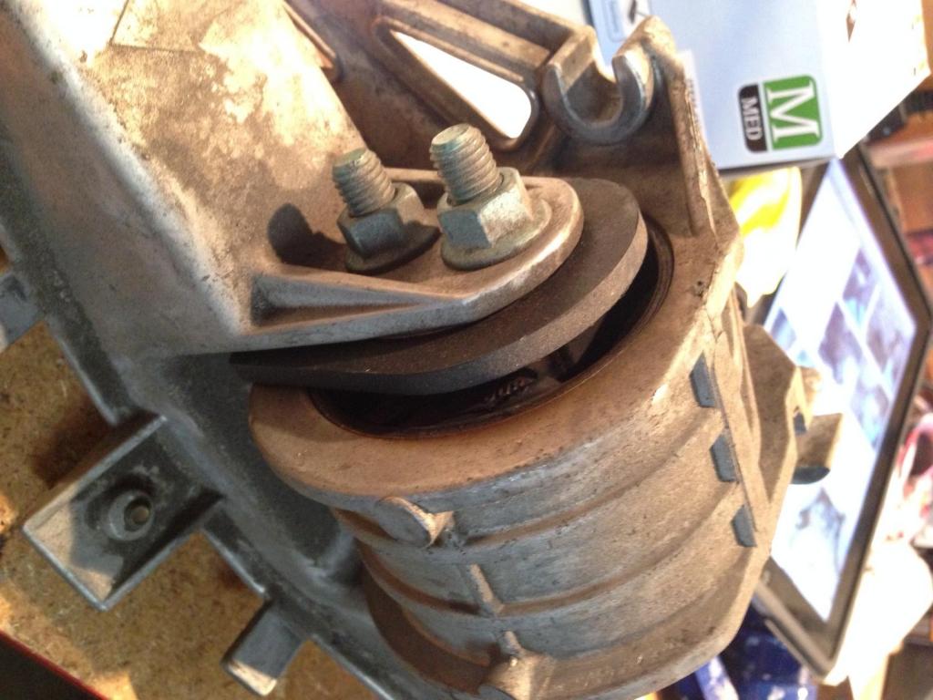

I have a question about the "stop" p/n 986-375-255-01.  When I removed the carrier/mount assembly, there was only one of them on mine on the "nuts" side of the bracket:

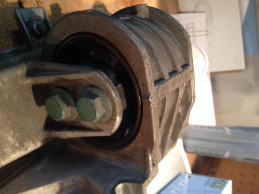

There wasn't one on the "bolts" side:

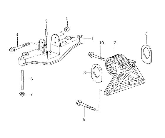

The parts diagram shows one on each side (#3 in the diagram), but as you can see above there was definitely only one on mine.  Should I have two?  Should I add another one?

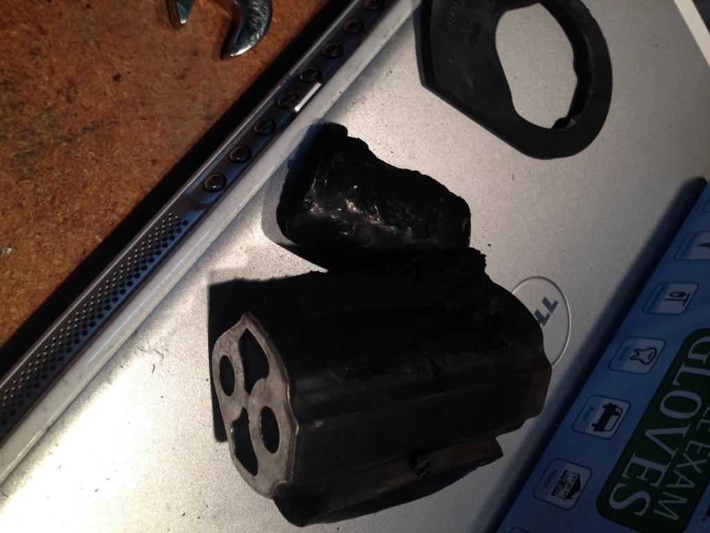

My mount was completely shot...the guts literally fell right out when I took out the bolts...
