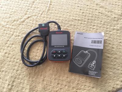

Has any one used this scanner? It is Porsche specific and does not require a computer. It reads all the codes and has a code library. It is updateable online. It is a lot cheaper than a Durametric which also requires a PC laptop.
I have all Apple computers.

It is also a lot less capable than the Durametric.

Thanx Guys. JFP, how is it less capable or what doesn't it do? Jl-c is right the Windows emulator does not work well. It is tolerable with Office but that is about it. It choked on my medical EMR. I am new to this code business. The yellow car croaked about a month ago. I had to have it flat beded to the dealer. The day before it had rained hard. It had codes in it that told the tech that it had misfires on three cylinders. All of my coils were cracked and water got into them. It cost me $1500 for coils and plugs. They sold me NKG plugs for $36 each! They are $4.95 at Pelican. Nobody told me that the original coils in 997s were crap. If I had known I could have watched for it and I could have done it myself for $600 if I could read the codes. Lesson learned. All I really want to do at this point is read the codes and reset the car unless there is something that could be very useful to me with the Durametric.

I have not spent much time with the latest version of this scanner, but these things are more code readers than a true diagnostic tool.  The one that I looked at could not read cam deviation values, would not reset air bag or service reminders, was incapable of re-coding a car (activating on board computers, cruise controls, steering angle resets, activate the ABS/PSM system to bleed air out of it, etc.), etc.  The fact that their advertising says it works on multiple European brand models raises a big flag as Porsche has long been known for have a unique diagnostic system.  Even the guys that make excellent diagnostic tools for VW and Audi will tell you that their tools are hamstrung on a Porsche and to go to Durametric.  I'm sure it will read global OBD II codes on a Porsche, but remain circumspect that it can function in the traditional "protected codes" areas of the car.  The only tools that I know of that can do that are the Durametric, PIWIS, and AutoLogic systems.  And before you ask, an AutoLogic tool set up for Porsche is approaching $12K, plus updates.

Thanx JFP. It is only a code reader and resetter. This particular version is Porsche specific and I do think it reads all the codes. At least it has one chapter on OBD codes and other chapters on stuff like the seats. I have no way of knowing if it is missing codes. $12,000 is out of the question. If I had that money now it would go into a Fabspeed perfomance system for the Turbo :-) I'll look into a cheap Laptop. The consumer Durametric is limited to three cars. Do you know what happens when you run out of cars? Can you buy an extension or do you just have to buy another one? The only other way out of this one is to spend twice as much on the Indie version. How do you get updates??
