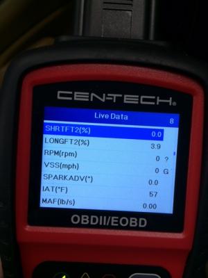

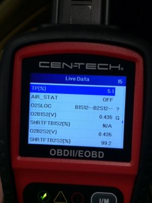

A little additional info.  I just hooked up my OBD2 reader with key on, engine off on a cold engine (approx. 50 deg).  I attached the photos of the reader showing all the pages of readings for the live data (there were no pending codes).
I then started the car and it was rough again (it's 100% consistent when cold). It idled at 1200 rpm, and it varied by about 100 RPM.  I also was able to smell a rich mixture from the exhaust.
I hope this info helps a little.

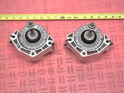

Usually the rubber in the mount is either torn or has sections totally missing.  This happens to be a transmission mount insert, but it will give you the basic idea:
I've seen failed mounts, but I was wondering if there is an easy way to see, or test them on this actual car.  I didn't look at them carefully.  Maybe I can just grab the engine and shake it to see if it moves?
If I am correct, they should be very easy to change on this car, right?  I have a lift in my garage, so that should make it even easier.  I'm not near the car now, so I can't look now.
It's very possible that the mounts are bad because I always felt that the car idled a little rougher than I thought it should.  I was just under the impression that it was normal because everyone says that they are a little rougher than the Boxsters and that's what I compared it to.  I had a 2001 Boxster S
You will need to support the engine while swapping them out, and may find that access from above may be restricted by some stuff that is removable, but they are not overly hard to change out:
There are also multiple aftermarket vendors of "improved" mounts that use replacement materials like urethane to improve their strength, but also tend to impart higher vibration in the process.
Because the turbo engine is a race derived unit, it shakes a bit more than the more pedestrian M96/97 street engines.  If the mounts are really bad, you can usually see the engine move when someone revs it.
