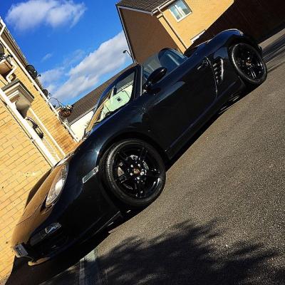

PS. Here's a shot of my Boxster... Photos make threads better!
