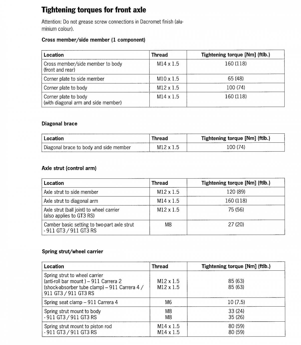

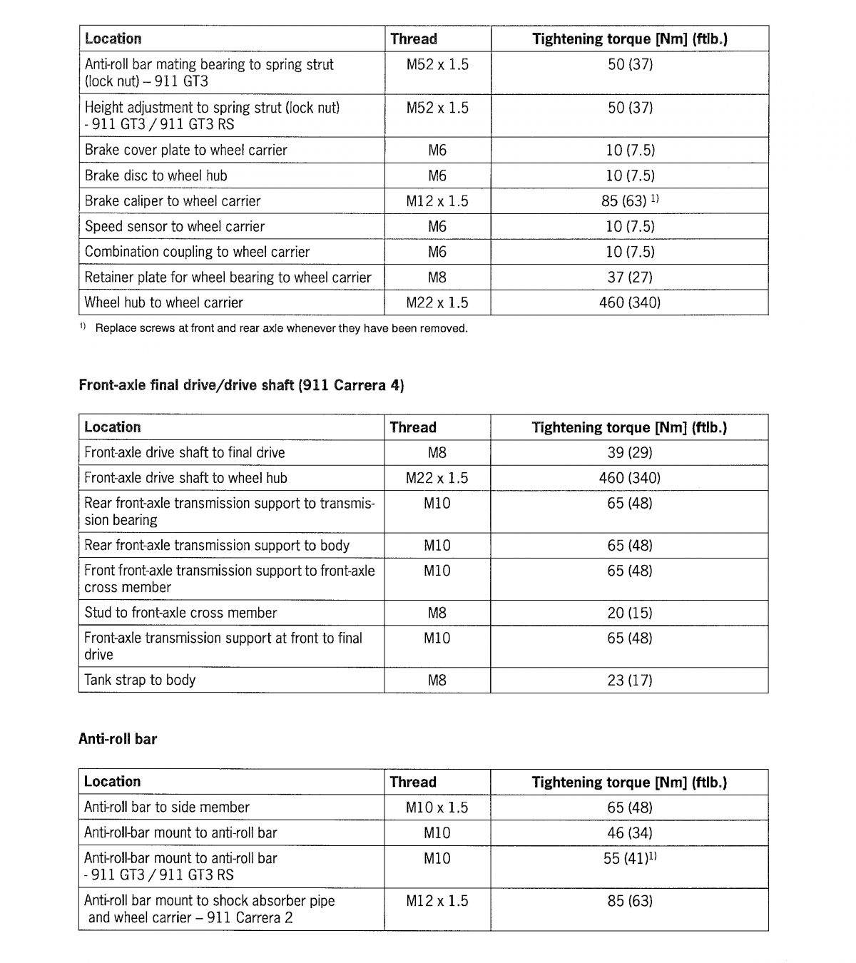

It's OK  as I think I have the info.  There are three bolt size.  The settings should be as follows:
10mm bolts that hold the "boomerang" plate and sway bar bush - 48 ft.lbs
12mm bolt that holds the opposite end of the "boomerang" plate - 74 ft.lbs.
14mm bolt on which the "boomerang" plate can pivot - 118 ft.lbs
I have found these descriptions and settings hard to understand from various print outs.  Like another poster who refers to Toyota manuals where the setting is given on a diagram which shows the part.
