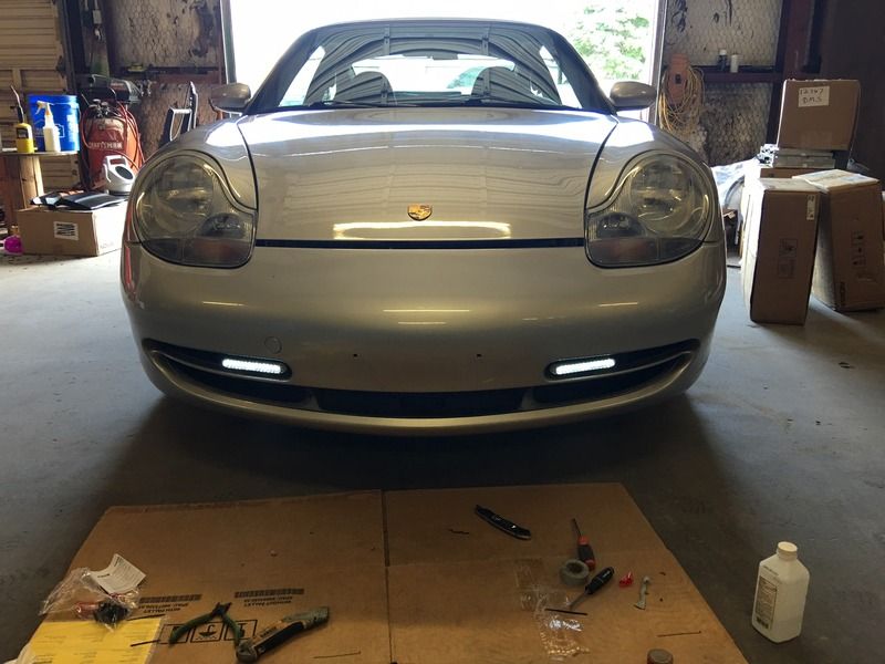

Hello all- I am a proud owner of a new to me 2000 996 Carrera. I have added LED running lights and ordered a short shifter after one week of having the car. I have the running lights set up to come on after start up and turn off when headlights are turned on.
My question is "is there some different headlight bulbs to put in that are white and not the old yellow color" ? Close to match the white color of LEDs.  On to a couple pics... Thanks for any help in advance.

Be extremely careful with aftermarket bulbs in these headlights.  Many of them run much hotter than the factory bulbs and end up melting the lenses:
If you want better, and much brighter headlights, look around for someone selling the Litronic HID factory lights for either the 996 or early (986) Boxsters (they are all the same).
These are way brighter, but actually run cooler than the halogens.
