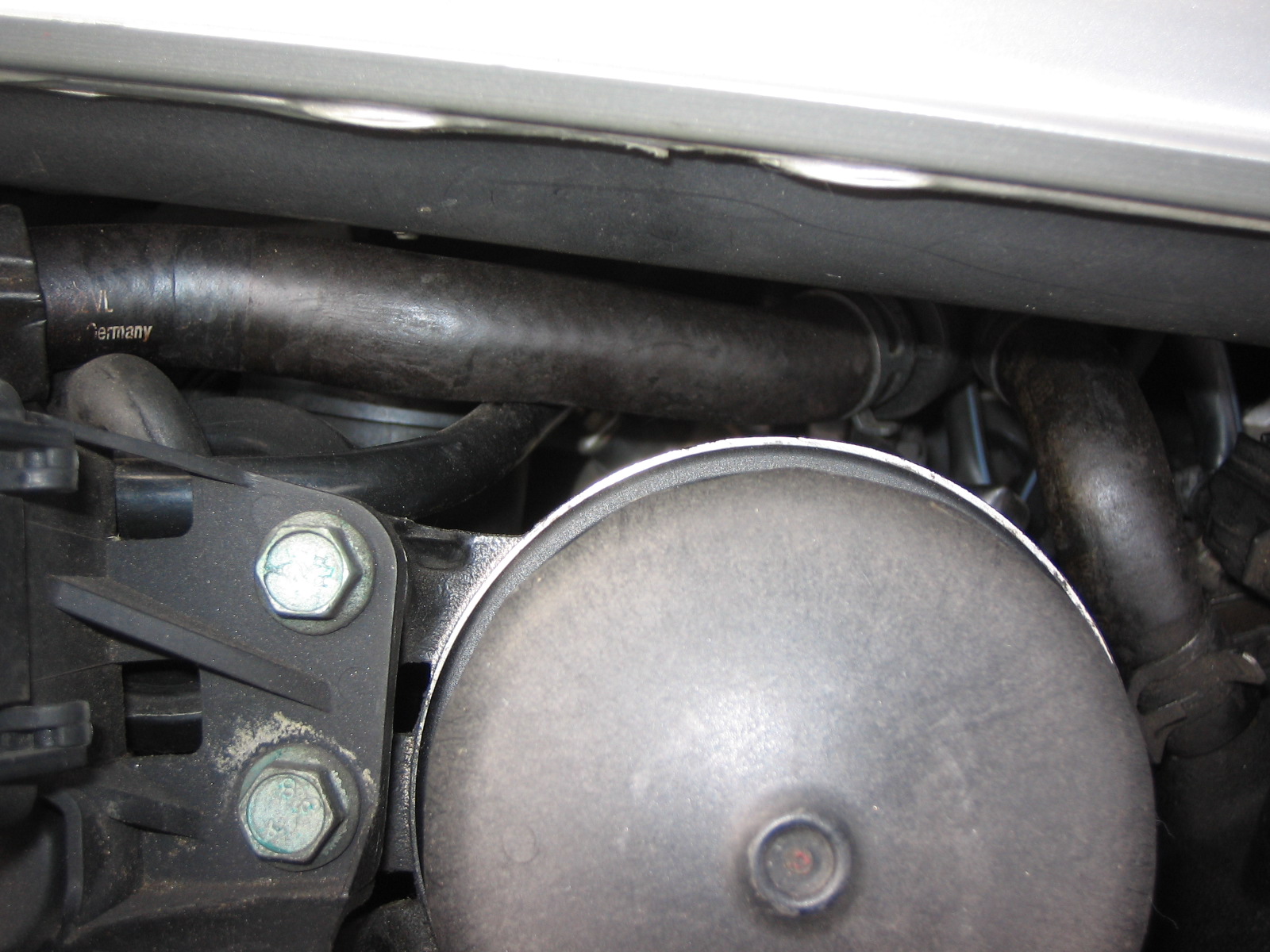

The oil pressure sensor on the 996 Turbo is on the top of the engine - right behind the oil filter.  Not easy to access, but possible.
58f3ac92b69ee_TurboOilPS1.thumb.jpg.b4a2f527a91f510e78a4eb94c3ebb7fb.jpg58f3ac7220a76_TurboOilPS2.jpg.9c36b03a8dfbd2aa1020f739f33a19aa.jpg

You gotta move the oil filter housing and you'll be able to reach it.

Lower the engine about 4 inches and it is lot better!!! Floor jack under the engine block and 2 nuts 18mm on the rear engine mount...... Oups that is probably fix already, old post......

I did this last weekend and removed the diverter valves instead of the oil filter housing to get to the oil pressure sending unit.
Not too bad a job if you lower the engine.
