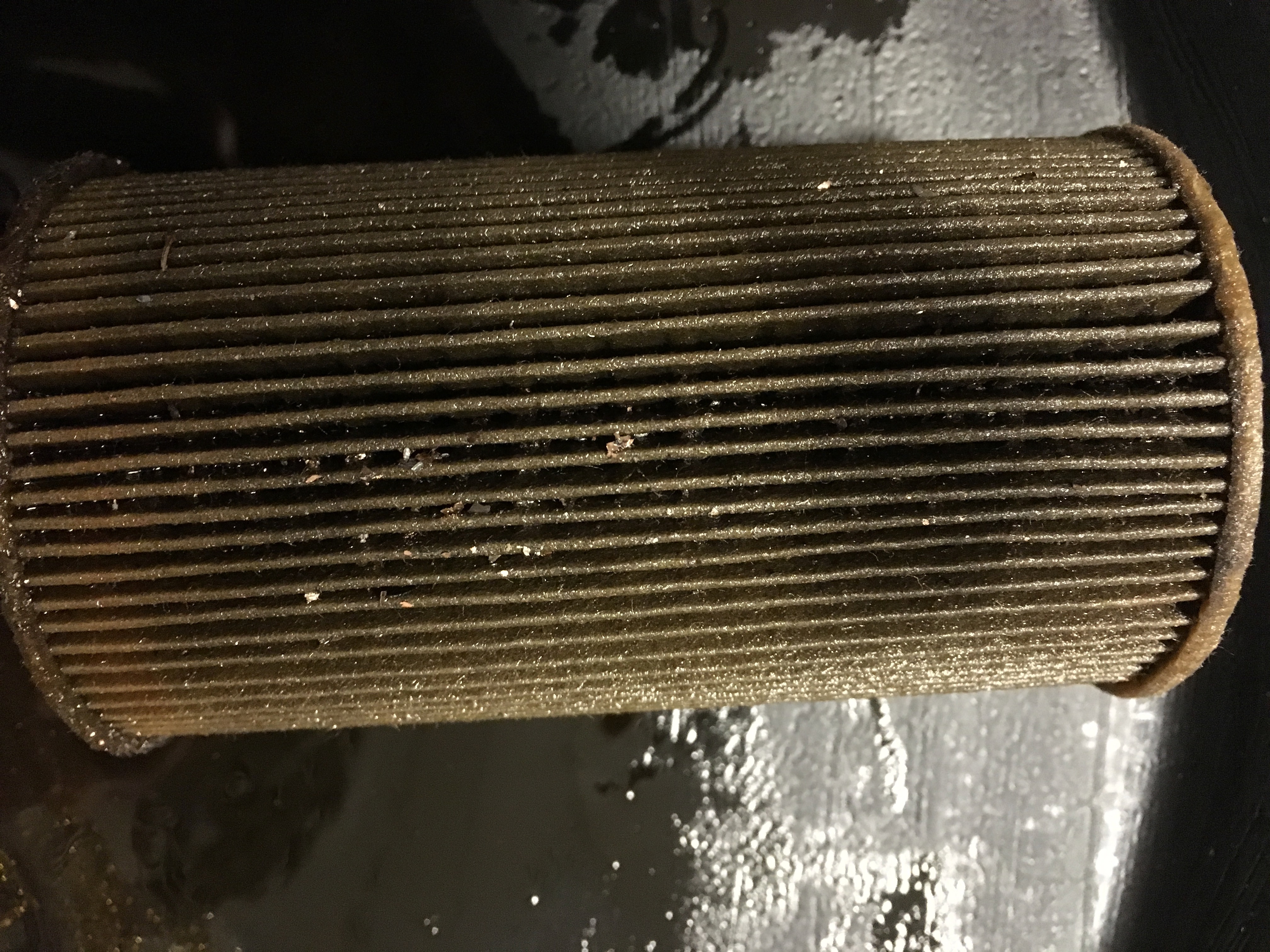

Filter will be first. I have the magnetic drain plug, which I may check next, and probably even drop the sump plate.
In the past, I have found a few tiny pieces of plastic in the sump, and a few specks of aluminum or other non-ferrous metal in the filter. They never concerned me before as they were very few and tiny.
My fear is that it may have lost part of a chain ramp or some other vital in the timing chain path that caused the misfire codes in bank 2 and engine knock, then a chain slackened and skipped teeth allowing the pistons and valves collide. But I am making this stuff up and have no idea what I’m talking about.

Talking with a local engine builder here in town over the phone, it looks like the gold flakes are a failed connecting rod bearing.  It most likely failed due to high cornering Gs that starved the engine of oil, probably damaging the rod and crank.  I guess an upgraded baffle may have prevented this. The earlier misfire codes were troubling, but may have been the AOS being overwhelmed and spraying oil into the intake, momentarily fouling the plugs on that bank. I guess can happen if the car is topped-off with oil while tracking, which I did--he recommends running the oil on the low side when at the track.
Makes sense to me, but we would have to pull apart the engine to fully diagnose.
Edited by brwilson
A second opinion from another builder confirms that the AOS probably failed, but he disputes that there was starvation.  He says the engine has weakness in the rod bearings that does not allow enough oil at high rpm, and the AOS failure probably caused some hydro lock that exerted too much pressure on the pistons. Lots of opinions.
