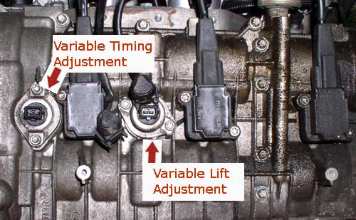

I have swapped the valve solenoid from bank 1 to 2 in the hope the code would change to bank 2 but it didn't. Any ideas before I start getting too far into over next few days?

Basically the P1328 error relates to an open circuit on Bank 1.  You will need to check the wiring harness connector, wiring, and may have to trace it back to the DME.  First thing I would do is unplug the engine wiring harness connectors on the  passenger side of the engine bay, and clean the connectors with some electrical cleaner.  Do the same for the solenoid connector plug.
