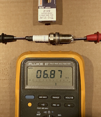

I'm wondering if there should be any concern regarding differences in the resistance of a set of spark plugs?
I just bought a set of Beru 14FGR-6KQU spark plugs. Measuring the resistance between the terminal nut and the center electrode, four of them are in a tight range of 5.6k to 5.8k ohms, and the other two are close to 6.8k ohms.
Firstly, does the resistance matter?
Is there a range of acceptable resistance for a single spark plug?
Also, should a set of plugs be fairly well "matched" in terms of resistance?
And lastly, I'm curious to know if the coils are expecting to see a certain resistance to the plug? and can the plugs have a resistance that is out of range for the coils to function properly or suffer a forced failure?
Resistance does not matter unless one or more has a huge difference.
What does matter:
Spark Plug electrode gap: 0.7 mm + 0.1 mm
Check spark plug connectors. Resistance: approx. 2 k ohms
Check ignition coil(s). The resistance between terminal 1 and terminal 15 at 20°C: 0.3 - 0.7 ohms
