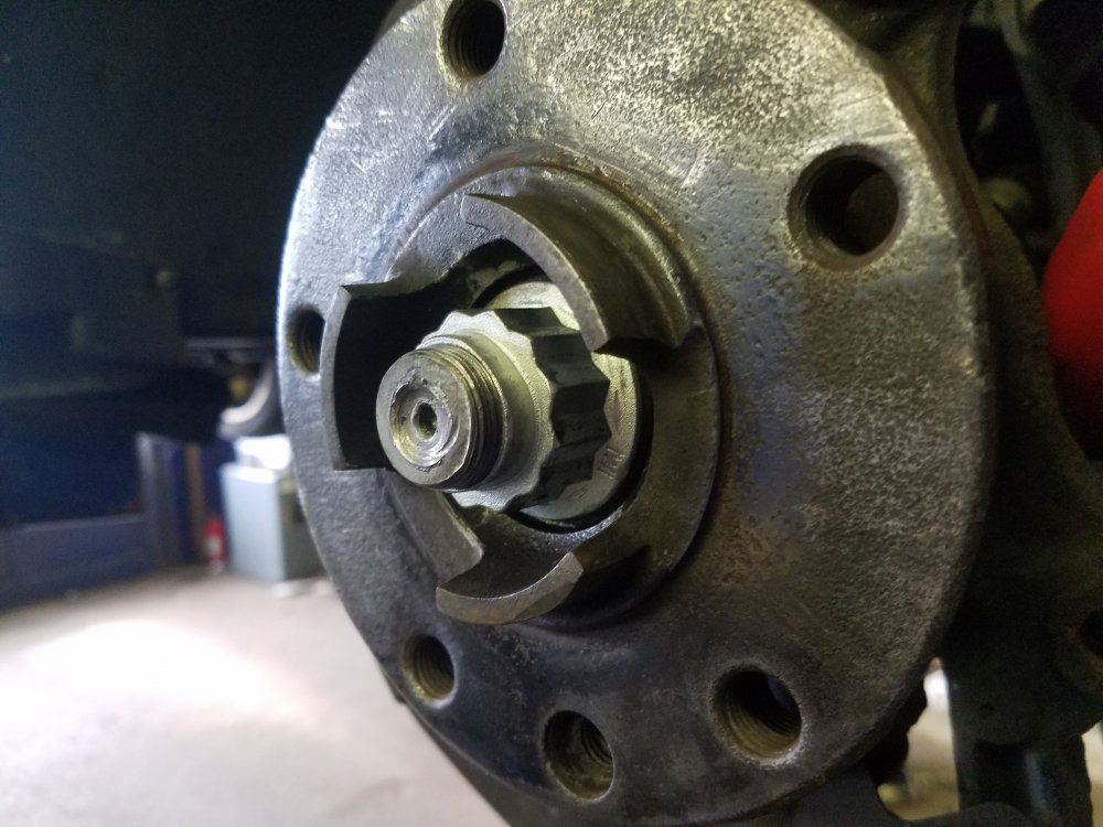

Below pictures of the hub in question  after they were cleaned by Rabe
Edited by romanimal
photos added
3 hours ago, romanimal said:
Thank you.  I have the car at Vertucci now and they are figuring it out.  I'm Confused about a few things though.
1) If good rotors were installed on bad hubs, wouldn't they have pulsated immediately rather than working great for two months and slowly deteriorating?
2) Will the dial indicator used on the rotors give a true indication even if the hub is out of round or would the underling hub warping flow through to the rotor measurement using the spinning tool?  Perhaps checking the thickness at various points with a gauge be more accurate in this case?
3) Aren't there some tension adjustments on the hub that can be adjusted?
(1) No.  If the hub bearing is bad, it would take a bit to cause uneven wear on the rotors.
(2) Not necessarily.  It all depends on how the rotor is rotated while in contact with the dial indicator.  If the rotation does not take up any slack in the hub bearing, the rotor could appear to run true because the hub bearing is not loaded.
(3) No. The hub bearing's are simply torqued to spec, which is quite a high value.
Get the disc checked on the car with dti (dial test indicator), if result shows they are warped, remove discs and recheck the disc and the hubs separately. You need to identity where the issue is.
If the hubs pass the dti test and the discs fail then this points to two issues, the discs are poor quality and susceptible to warping (bad batch or metal heat treatment process), or the caliper/pad is not functioning correctly, sticking binding, uneven pressure etc.
On my ctt the brakes would squeal and I regularly had to strip off pads and clean and apply copper grease and also anti-squeal fluid to pad surface. I wonder if your brakes are binding and causing over heating this may explain the previous hub warping issues as well?
Trying to think outside the box now without throwing more parts and money at it for the same reoccurrences.
