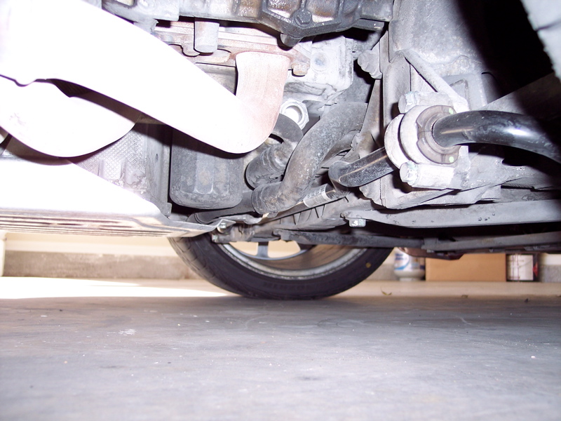

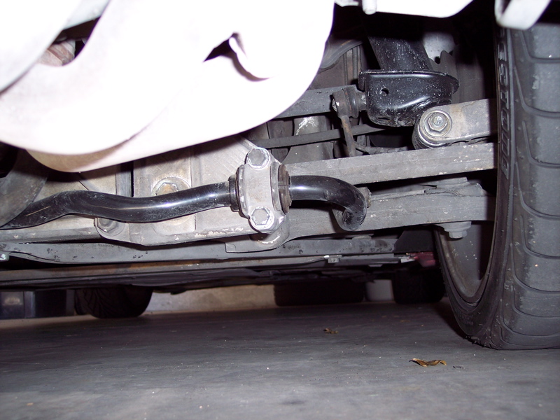

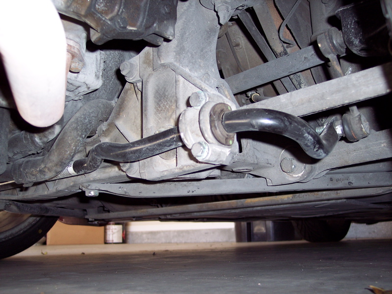

2. Can some one post a picture of the mouting of the front and back sway bars?

2. The sway bars mount the same for RoW M030... and in some models are the same as US M030. If they change all you change are the mounting bushings and the sway bar.

Excuse my ignorance, but can you snap a photo of the cross bars or are they nicely hidden? I'm not sure where they mount them? on top of the shocks or underneath...
Paul
Drpaulmarsh. The sway bars just replace the stock sway bars. The rear one is really easy to swap out; just have to loosen 4 bolts on the chasis and one on each drop link. The front is a little tougher to get at, since you need to take off the plastic cover under the car and also loosen the diagnonal braces, but that just adds a bit of time. Changing out the sway bars is the easiest part of the install.

Paul...the rear is an easy one to take a pic of. I'll try to remember to snap one tomorrow. C4 is right about where they are.
