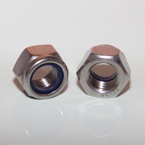

To replace drive shaft boots and strut mount, I have disassembled the wheel bearing carrier. The porsche manual says to replace all safety nuts for the control arm, track rod, drive shaft!
This is O.K. so far, but I read nothing about using Loctite or similar glues on the threads. What is the advice here, if I replace the nuts anyway? Do I need additional glue?

I personally would use Loctite blue (or equal) on all nuts and bolts that do not have lock nuts
O.K., but how would you understand the manual? For me it reads like Porsche would not use any glue on the standard nuts!
How do you recognize which nuts are safety nuts? Description in the parts list?
