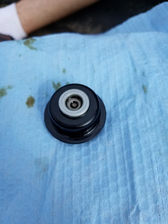

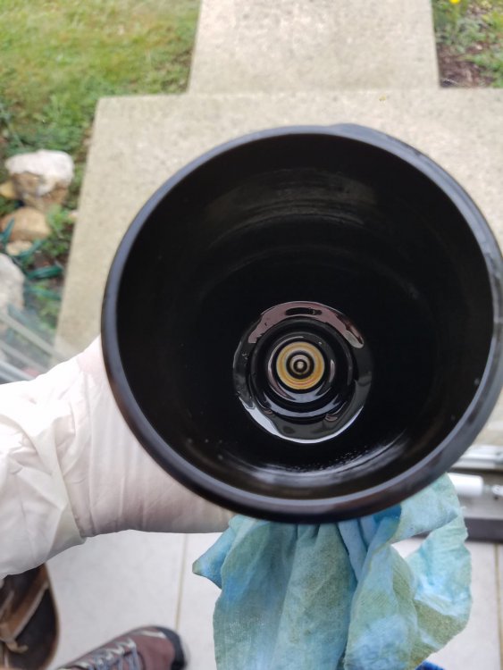

The oil bypass valve came out with the old filter and not the canister. I got the direction wrong when I put it back in (picture 1), which is why the oil filter/canister threaded half-way by hand without issue, and required a wrench to turn the rest. Pulled the new filter out last night to reverse the direction and noticed the filter tear (picture 2). So, for that last half-way of threading I was destroying the filter.

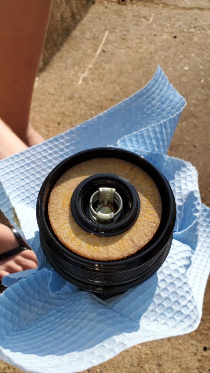

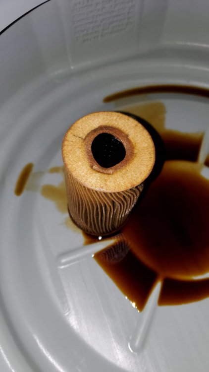

If anyone is doing a first-time oil change and you happen to have the bypass valve separate from the canister (picture 3), make sure you either seat it in the bottom of the canister (picture 4), or (what I had to do), press it into the bottom of the filter, press the filter on to the car, and finally finish by threading the canister on.
After I finished this process, I restarted the car this morning and after about 2 seconds of running with no pressure/oil pressure warning light on, the pressure bounced immediately up to 4+ bar and the warning light went out.
