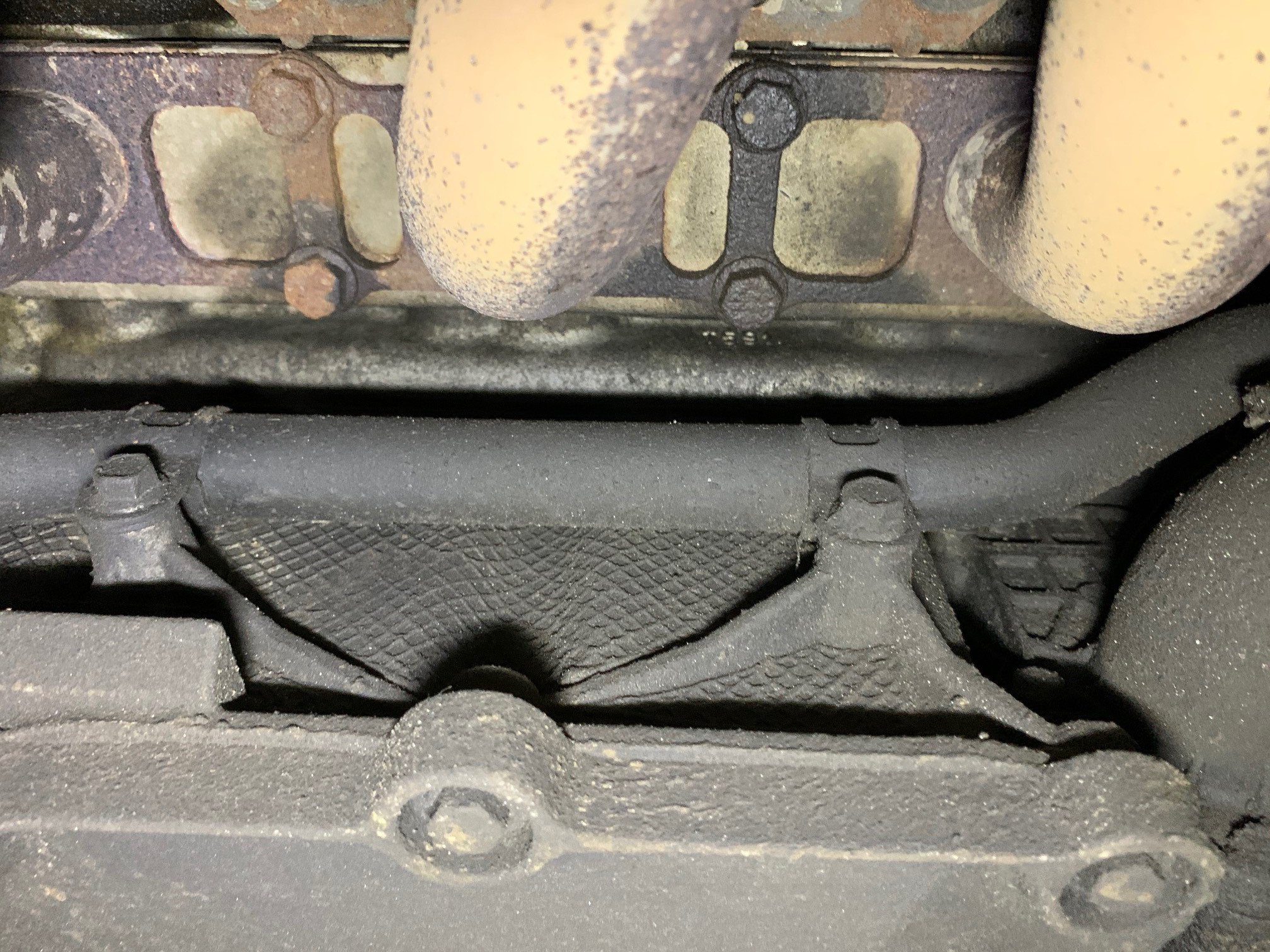

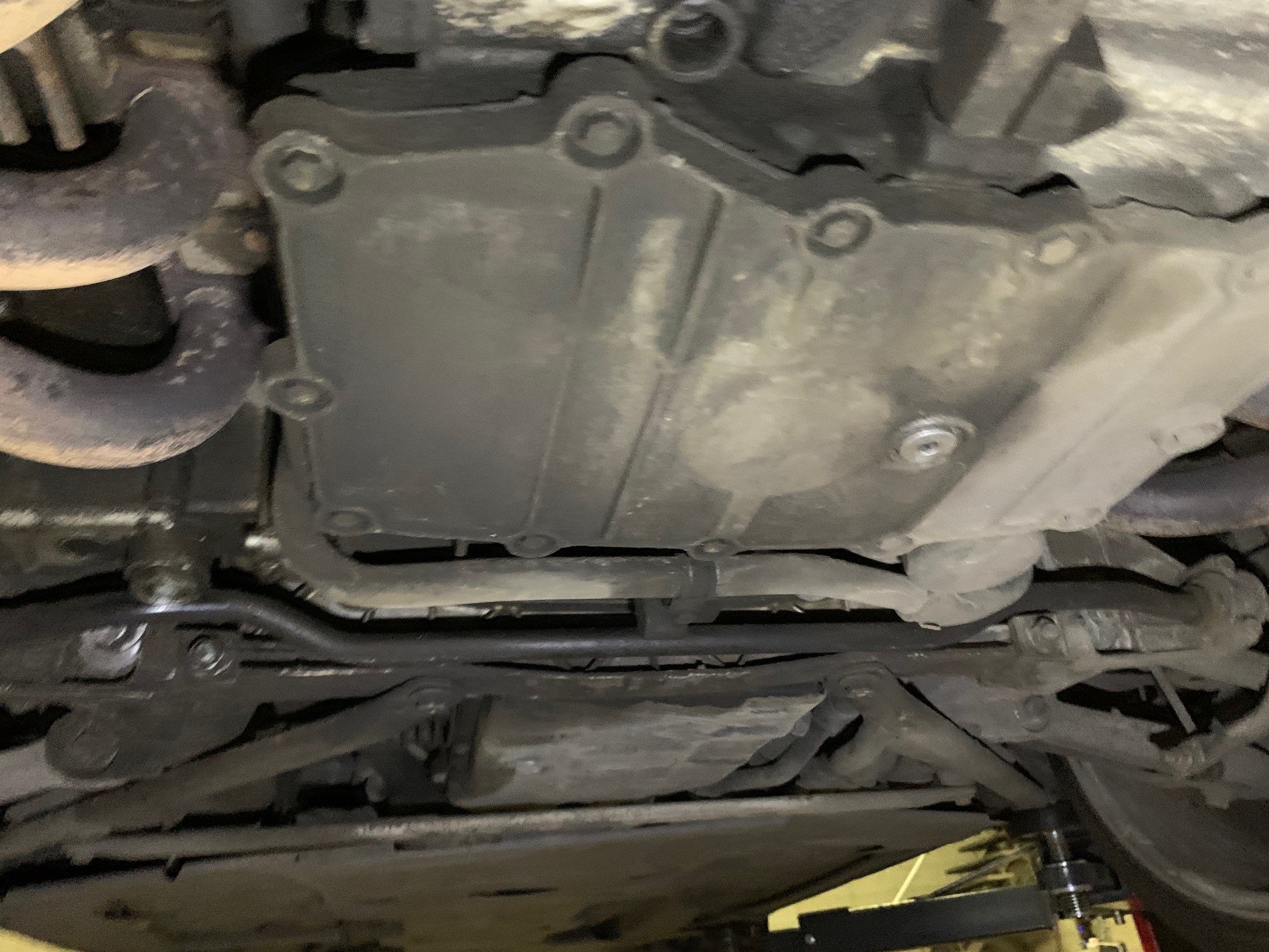

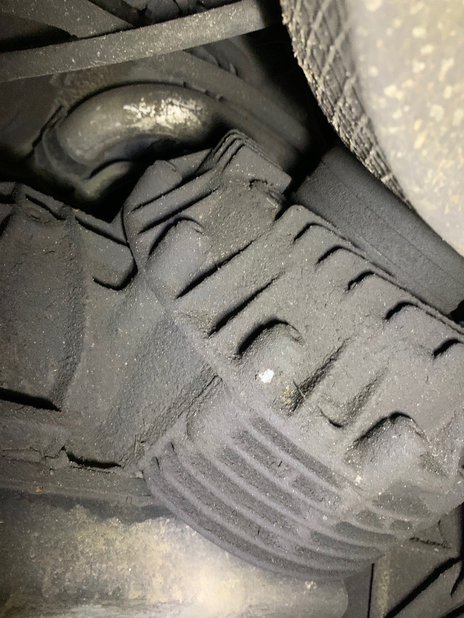

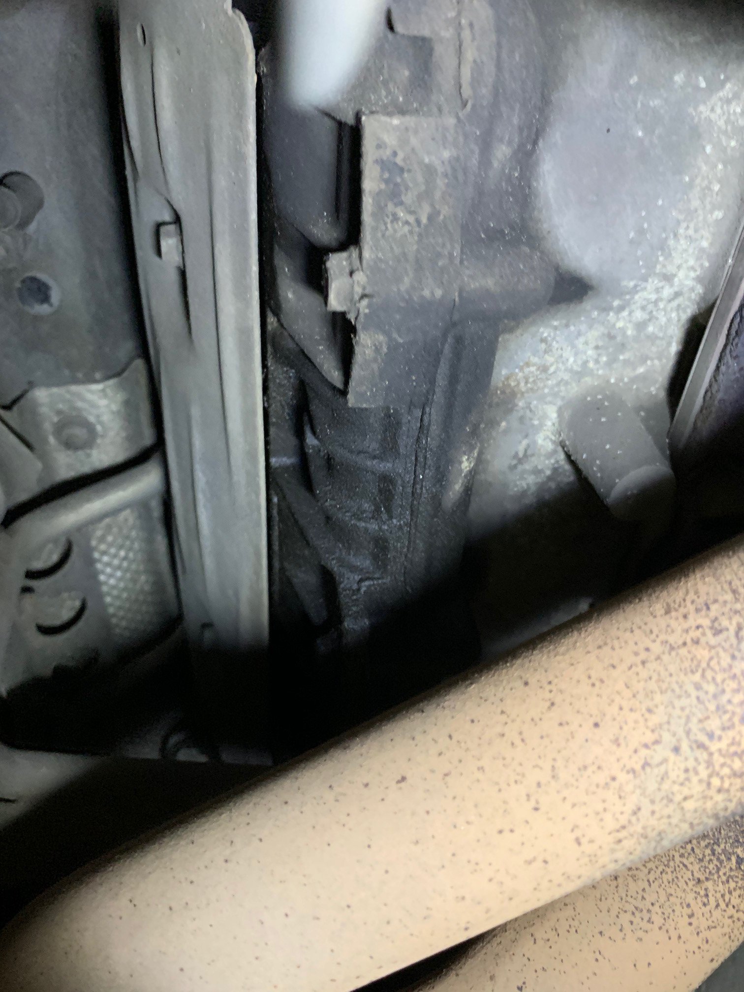

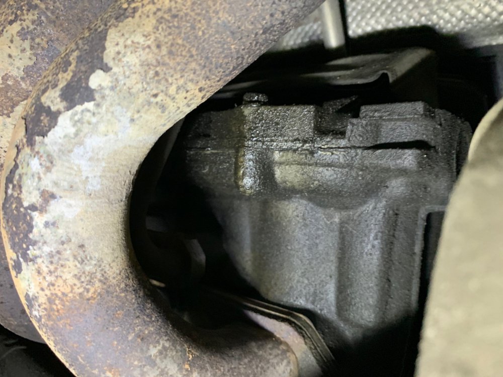

For the good news, I had the chance to have a clear look under the car and I was happily surprised to see no leaks, maybe one on the side of the tiptronic. ill show the pictures. but for the rest, it looks like its still under decent condition
