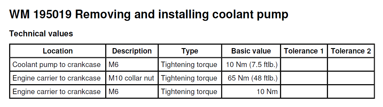

I read that the seven bolts that hold the water pump on are torque to 7 foot pounds.
Is this right?

Wow.
7.5 foot pounds.
I expected alot higher.
Thank you Loran

Water pump bolts are a perfect application for an inch pound torque wrench. 😉
Share this post
Once he snaps a few off he will get that...  🤣
