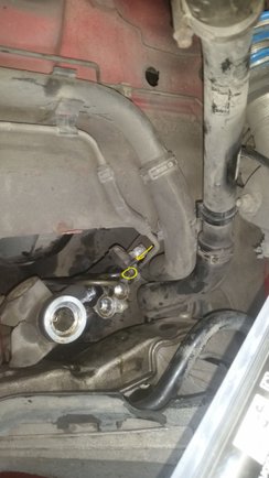

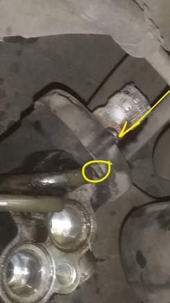

The steering rack itself has a straight ahead /middle position.
You set it by lining up the pin in the black plastic cap with the hole in the alloy tab (by turning the spindle).
20220607_194218_74721c2abfe5056d7d448952
20220607_193928_e832936e32d55c6afbec75fd
I understand you found one of the universal joints to be the cause but the above info becomes relevant when you put it all back together to complete the repair.
