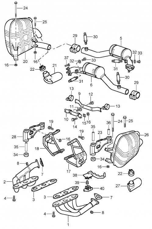

Could I know the parts number of the 3 bolts that hold the muffler mounting bracket?
I'm going to remove the muffler so, I'd like to replace the bolts.
I would appreciate your help.
48 minutes ago, Loren said:
Which item number please?
I'm sure but it may be 19 and 16 if they hold the muffler mounting bracket, 3 qty. each side.
Thanks,
Item 16 is 3 nuts per side that the muffler (mounting bracket on the muffler) to the mounting bracket on the car.
Item 19 is 2 bolts per side that hold the mounting bracket to the chassis.
When I remove the mufflers I just remove the 3 (per side) nuts 16. I have never seen any damage on these.
