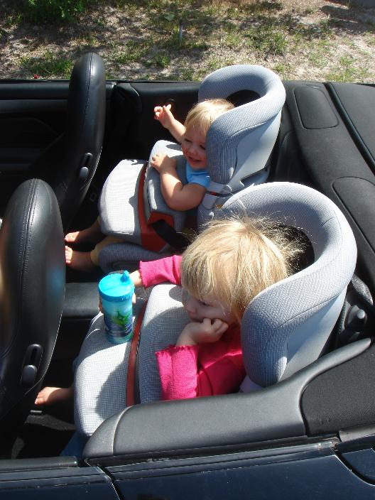

We also went from a 986 to a 996 cab for the same reasons. In the beginning, we kept our 986 for a long time with our first infant riding in the front passenger seat with just one of us (usually just my wife and our first baby), and eventually after we had our second we got a 996 so that all four of us could ride together. I didn't see any really complete responses here on this one, and we have a lot of experience with this so I'll share what I can. We have two kids, now 3 yrs 1 month and 19 months. They have both been riding in our 986 and 996 cars since they were born. The older one has always enjoyed it and crawls into the 996 whenever she can (even when we don't intend to take that car). The younger one's stomach doesn't always agree with it, even when in the front seat. We have the 17" wheels with soft shoulders on the tires (Goodyear Eagle F1 GS-D3) and stock suspension, so as far as a 996 goes, it's the softest ride they can get.
Infants must ride in the Porsche Britax infant carrier in the front passenger seat (see attached pic). 996's and 986's must have the airbag deactivation kit installed, which results in an extra buckle under the front passenger seat that is used by a belt coming from the forward section of the infant seat. 997's and 987's have airbag deactivation switches and don't require a separate kit to be installed. You should not put an infant in the rear seat of a 996, the carrier was not designed to seat & secure properly in the back. As a result, when we used the infant carrier in the 996 and all four of us went somewhere, my wife had to sit in the back. She's only 5'-4", so it wasn't too bad for her. Just a comment - we LOVE having the infant carrier in the front, because the baby is always within the driver's immediate reach and within peripheral vision. There is nothing else like it, you can't do this with any other car on the market that I know of, because all other rear-facing seats are required to be installed in the back seat of other cars.
The Porsche junior seat is the next step (starting at 12 months). This is a forward-facing seat that can be used in the front or rear. It also has the special front buckle for the airbag deactivation kit when used in the front seat, and it has the rear strap (presumably for use in the Cayenne) and the seat latches, but in the 1999 996 we have, we cannot use either the rear strap or the latches. We just secure the seat in place with the rear seat belt. They can use this Junior seat for a very long time (the back even expands upward), but until they're much older, they have to use the lap pad. When they get older, they will just be using the seat with a seat belt across it (including shoulder strap run through the special routing clip). We currently have two of these in the back of our 996 (see pic of junior seats), and sometimes we move them to our SUV and use the safety strap and latches in the SUV.
Another note - there is somewhat of a gap for infants 9 months to 12 months. At about 9 months, they're almost too big for the infant carrier, but you're not supposed to face them forward in the junior seat until they're at least 12 months. We continued to use the infant seat carrier past nine months and their head was well within the side supports on the seat, but their legs were sticking way out.
I can't comment on the seats for older children yet, it will be a few years before we outgrow the junior seats, but the other pictures posted previously provide a picture of the booster.

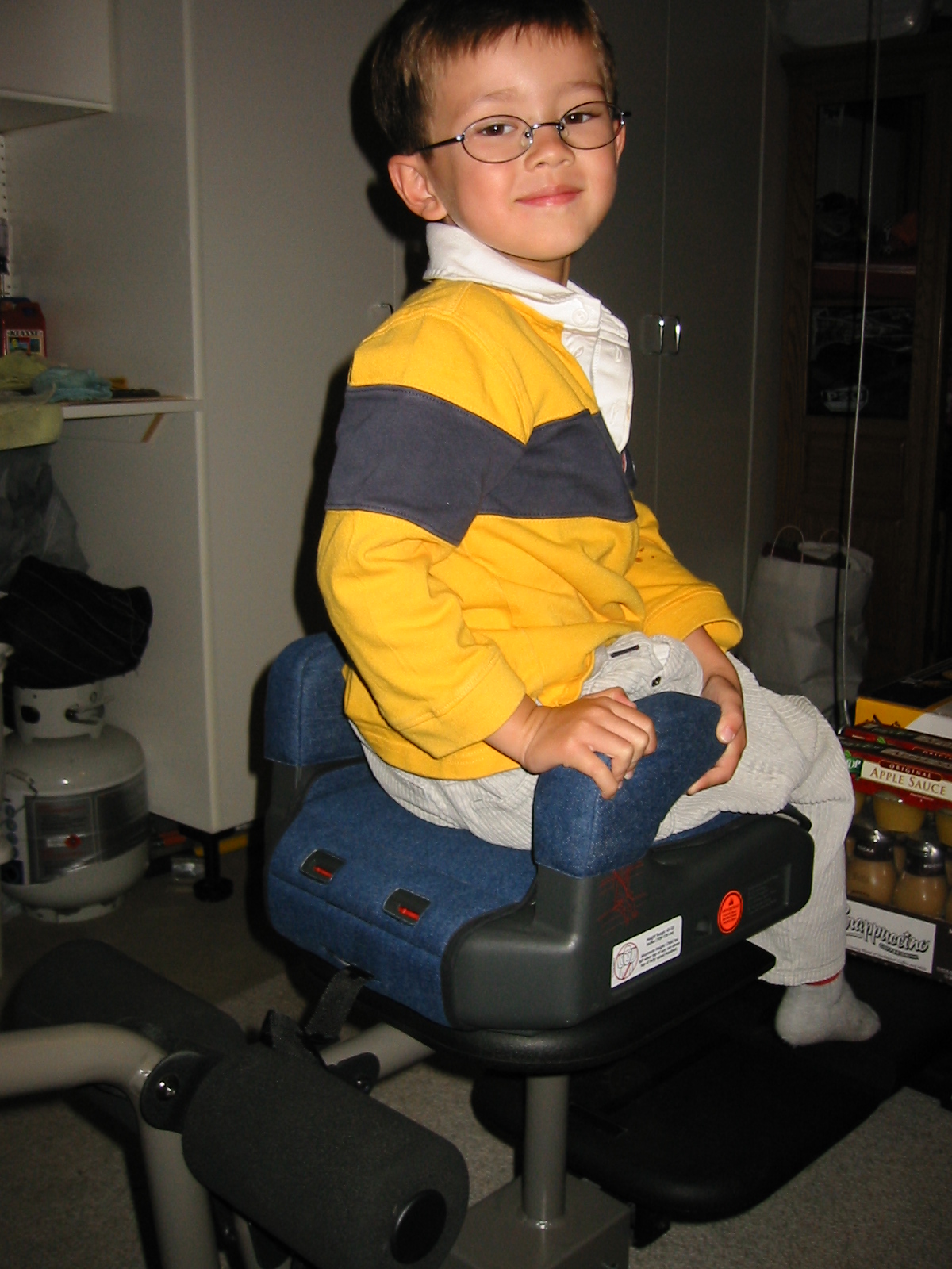

I have 3 kids in my '99 Coupe a couple times a week, because I pick them up from Daycare. Oldest is 4. I worked this child seat issue really hard and tried a number of products. As the kids have gotten bigger, the solutions have changed. Here's the saga.
#1 son started out in a Eddie Bauer seat, exactly as pictured in a previous post. But then he got big enough that he kept pushing on the passenger seatback with his feet. So then I got him a little booster seat at Walmart for ~$20. I cut off it's sides so it would be thinner and fit in the back better.

One of the twins is now too big for the Eddie Bauer car seat in the back, for the aforementioned reason. So #2 son is now in this harness sort of thing that I found on the Internet. Look up the Freedom Ride. I had to monkey with the Freedom Ride to make it easier to put on, but it seems to hold #2 pretty securely. Soon #3 will go into a Freedom Ride. And a year from now the twins can probably be trusted to not monkey with the OEM belts, and I'll get plastic boosters, cut off the sides, and use those little padded things that bind the lap and shoulder belt together so the shoulder belt doesn't ride too high.
