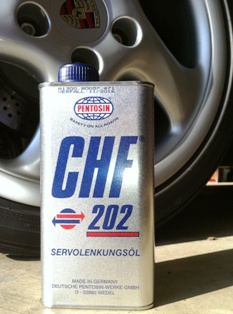

I too had a some difficulty finding the right hydraulic fluid. I couldn't find Pentosin CHF 11S anywhere locally. I called my local Porsche dealer, and they said that the Pentosin CHF 11S (Porsche P/N 000 043 203 33) has been superceded by Pentosin CHF 202 (Porsche P/N 000 403 206 56). I don't think the 202 is better, it's just that Porsche isn't stocking the 11S anymore.
Picked up a liter of the Pentosin 202 for $21.77 with my PCA discount. Not bad for a dealer!
The rectangular silver can of Pentosin 202 states that it is compatible with the 11S.

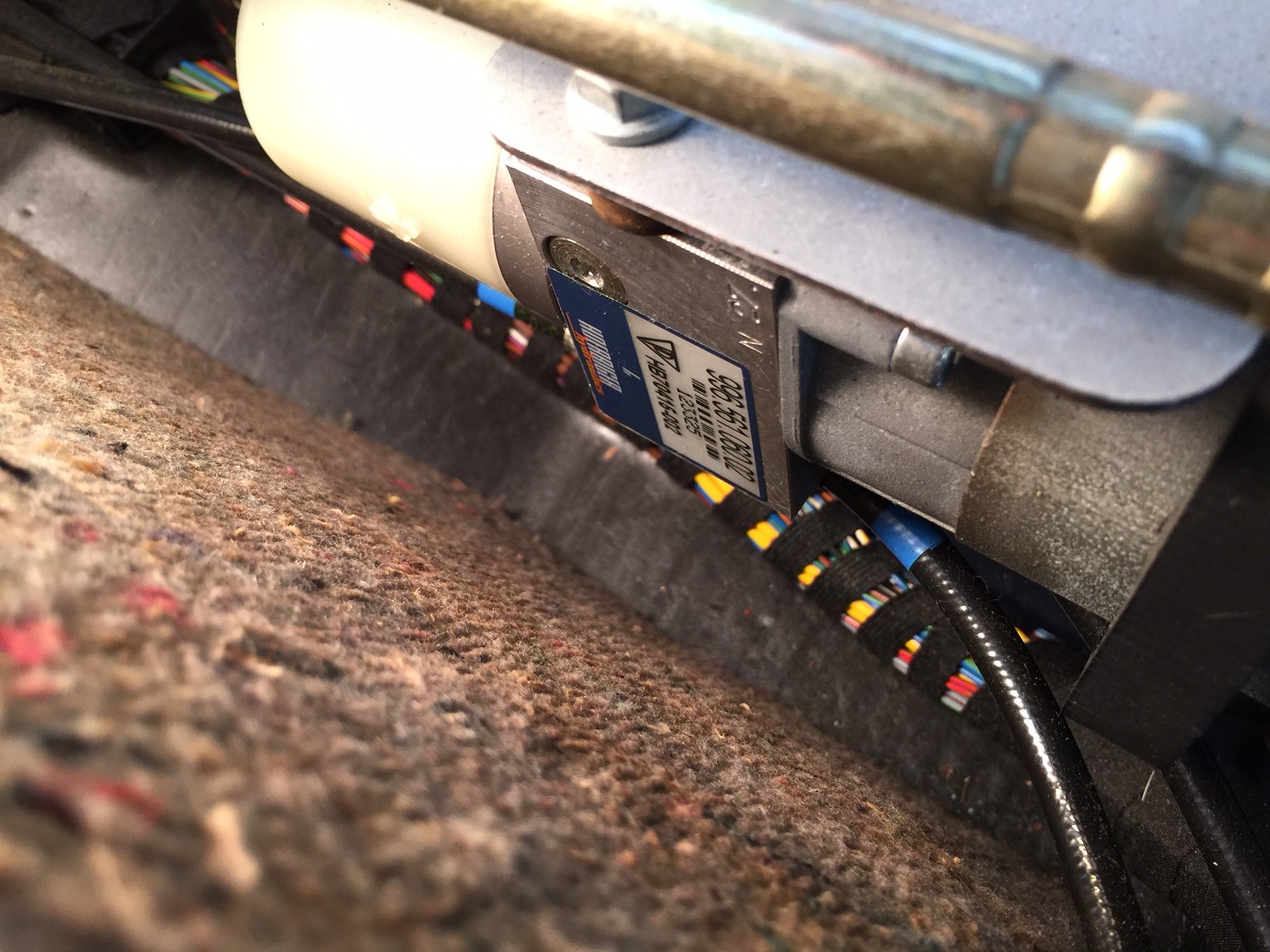

On my '04 996TT the pump and reservoir are installed horizontally, not vertically like shown in the DIY. A small bracket mounts the pump assembly to the vertical body panel. In this position the fill plug is pointing downwards, so I assume that I'm going to have to remove a few pieces to maneuver the pump and reservoir into position so that it can be filled. Interestingly I haven't read any other comments from people with this setup, so for now I assume that this change came with the 996.2 body update. Something to consider if you are going to do this repair. Cheers.
EDIT: It turns out that the cap is located on the "bottom" of the plastic reservoir on the driver's side (it screws in horizontally). There is no need to remove (or even loosen) the pump assembly. The syringe with a small diameter tubing will easily empty the old fluid and allow you to fill with new.

I have an '04 996 C4S and mine also has the pump and reservoir horizontally like Wkoperwhats.  I've attached a photo.  The hex plug on mine was 4mm, not 5mm.
I was not so lucky. I did successfully fill the reservoir, but I can now see I'm going to have to replace the seal on the right side actuator.  After filling the reservoir, the telltale hydraulic fluid is on the garage floor just in front of my right rear tire.
