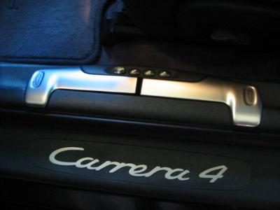

Is it possible to obtain just the lever, and not the entire assembly? My painted plastic part is scratched/damaged, and I'd like to replace it, but my dealer only sells the entire assembly (large dark plastic housing, with both levers already attached). If the car has the memory seat option, the whole assembly sells for almost $500 and you can't get the levers separately. Any ideas? Thanks!
I don't think you have a choice - I've heard they don't sell the silver mechanism anymore only the black Boxster version. I think that is why folks take them off and paint them themselves. When mine get scratched enough I will likely just paint them too.

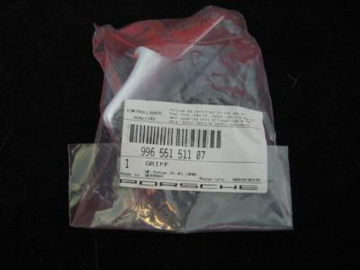

By the way, the part number for the front hood lever is:
996.551.511.07
I bought it on eBay, but I'm sure you can have your dealer order it. It's about $100. Here's a picture:
It looks awesome once again!! Thanks!

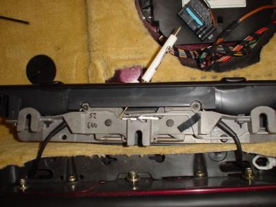

I've been trying to loosen the three allen head bolts holding the sill in place.
I removed the plastic caps, and pulled the carper out of the way so I can at least see what appears to be the forward allen head bolt.
How in the world can I tell if I have the allen wrench on the forward bolt? Also how were you able to get to the middle and rear bolts as I can't even see them thorugh the holes
in the sill since there is no room between the seat and the sill. Any suggestions would be much appreciated.

Unless you have just the right length allen it is hard to get to the allen bolts with the seat in place. Also hard to see them.
When we did it the seat was out. I would suggest you unbolt the seat, and perhaps you can move it around without having to remove it from the car. Once the seat is not blocking your view it is easy to loosen the allen bolts.
There seems to be a dispute if it is a 4 or 5mm allen. It has been a few years since I did this. I think it was a 5mm.

You can get to these Allen bolts (honest, I've just had to do it myself after my battery went flat and I could not get to the engine to jump start the car) without removing the seat. Move the seat back and forth / up and down to gain access to each one. You then use the long end of a 5mm Allen key, at a slight angle. Undo the bolts three turns and then carefully prise up the mechanism.

I just removed these bolts without removing my seat. It's a 5mm allen wrench for my 02 4S. Pull the plugs out slowly so you don't lose them and then insert the long end of the wrench into the hole. You have to stick the wrench in at least an inch before it engages the bolt. You don't have to remove the bolt completely, just loosen it. I removed mine completely and they fell down into a spot that was hard to retreive them.
