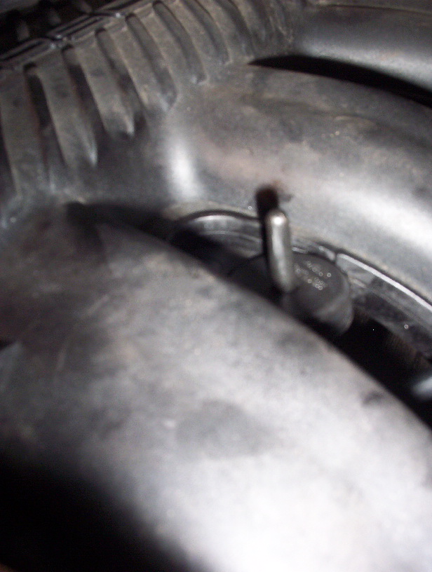

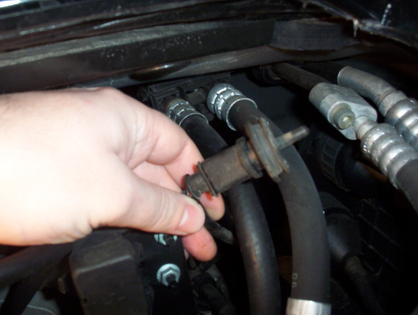

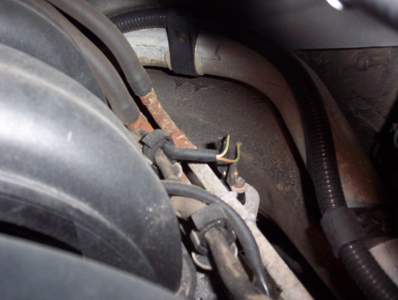

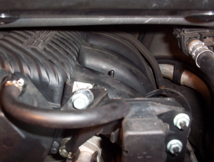

Resolved ! - Thanks to all - It was indeed the sensor that had fallen off and was resting on the engine block itself.
It fits in the first gap between the first two inlet manifolds on the right hand side of the engine - took some pictures to assist if anybody else has the same problem :-
1. I traced the wires going into the inlet manifolds and pulled out ...
2. I tried to fit it into the holder but found it too tight and didn't want to foce it. Therefore, I took out the sender from the grommit, used some WD40 on the grommit and slid that in first...
3. Then it pushed the sender unit into the grommit from underneath until it clicked into place.
4. A picture of the sender poking it's nose into the air taking the ambient air temperature - as it should be !
