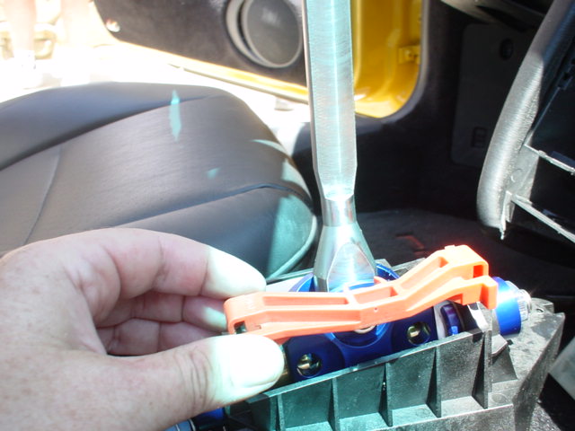

Nope, the blue tool fits the B&M shifter.
Before the blue tool existed Tool Pants and I used the orange tool to check the cable alignment -before- we removed the original shifter. Then you mark or count the threads on each cable to the end (when properly aligned). When you install the B&M you put the cables in the exact same (aligned) spots.
Thanks Loren. I marked the cables as you described when I installed it. It worked fine but after a couple of years of racing I'm having trouble every now and then. Specifically shifting from 2nd to 3rd at red line. I thought I would check the alignment.

I met Geoff in November and checked out the blue tool. I do not think it will fit on a B&M because the metal shaft is fat and the "pinchers" may not clip on. But I have never tried it on a B&M. If the blue tool works with a B&M then let us know because I will then buy one.

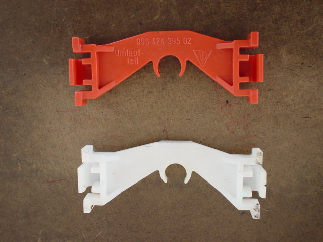

There is also a white tool but it is identical to the orange tool, and neither will work on a B&M.

Too bad. But at least you tried. And I suspected the blue tool would not work because the B&M/Porsche clone has a fat shift lever with a "hump" in it and you would not be able to clip the tool on. This was the same problem with the orange tool or the white version. The blue tool for the Porsche factory 997/987 short shift does not solve this problem.
When the black Porsche clone (original B&M blue) came out for the 996/986 Peter and I went through the tool catalog and the Porsche computer to see if there was a new tool for the Porsche clone, since we could use it on the B&M. Nothing. Then he showed me the white tool, but it was identical to the orange tool.

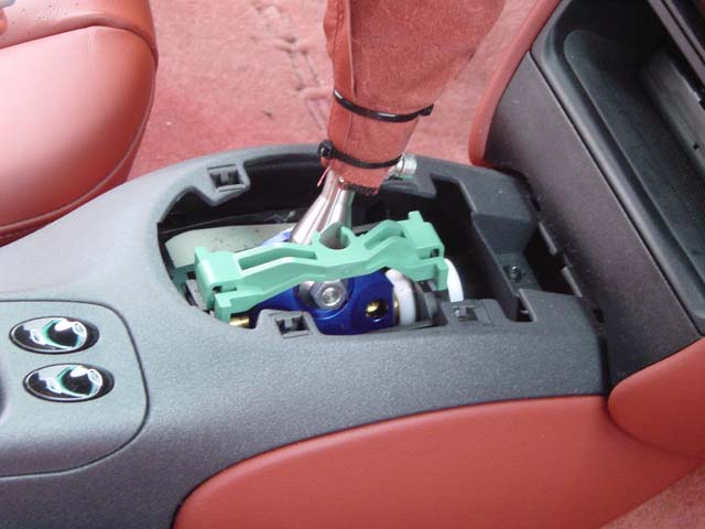

If I were you I would start with the green version, because it has an arch to it, unlike the almost flat versions of the red and white tools.
I was not able to order Geoff's blue version because it had a standard 997 part number, and not a tool part number. Plus his blue version is identical to my green version. Porsche is a funny company. They put part numbers on the back of the tool, but it is not a tool part number. Tool part numbers start with 000 721 - then you know it is a tool. My green version is 000 721 961 91 when you order it as a tool.
The "pinchers" of the tool are not wide enough for the fatter B&M shaft. I also think you would need to raise the arch even more than the green tool so that the pinchers can snap onto the shaft.
These pictures are of the green tool on a spare standard 996/986 shift tower, so they are just a guide. I wish I had a B&M loaded in the tower so I could take measurements.
