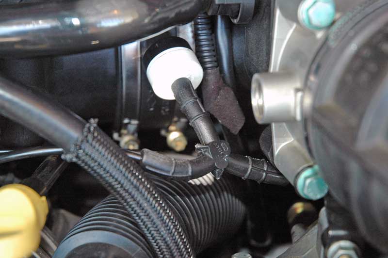

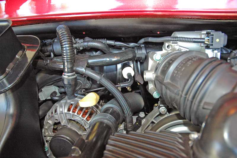

The easier more efficient, better way of getting a vacuum tap is to simply add a Y connector to the existing Vacuum tap on the back bellow as seen below:
Here is what you are looking for:
and by adding a Y connector this tap you end up with this:
One line goes to the existing vacuum switch, and the other goes to the PSE vacuum switch. The white and black plastic round thing is a one-way valve to keep the vacuum line to the switch (and in the case of the PSE, the vacuum tank) evacuated when the car is off. There is an extra one of those in the kit as well, assuming that if you install the other bellows, you will need the valve as well.
The extra bellows that come in the PSE kit is for those cars (the PSE kit is a All Of World kit) that don't have a emissions related vacuum switch installed at the factory. It does not mean that you have to install it!
Does this clear things up?
