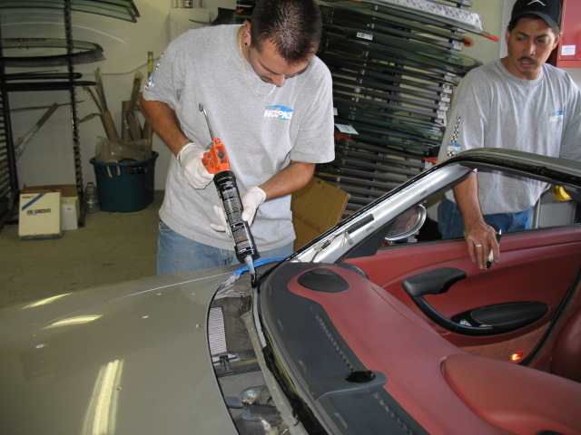

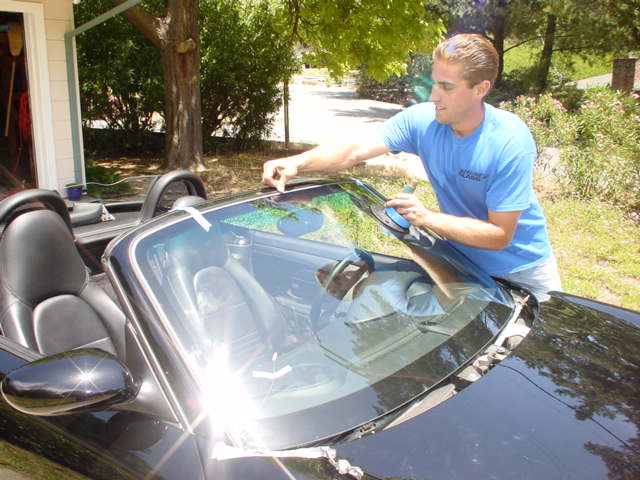

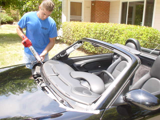

This thread is so old that I am already on my 3rd windshield. This time I removed the trim. Then the guys cut out the old glass, cleaned up the frame, and glued in the new windshield. Pictures are my 1997 with windshield #3.
Watching them working - it is not a difficult procedure. But experience sure helps. Plus, if they break the glass when putting it in then it is on their dime.
Maybe I'll give it a go when it is time for windshield #4.
