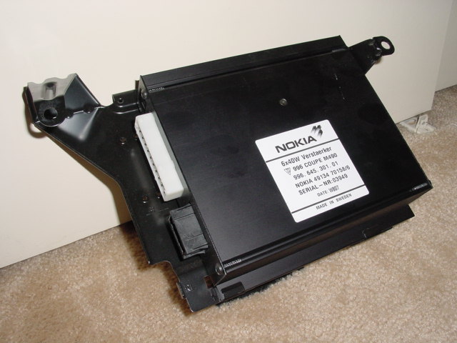

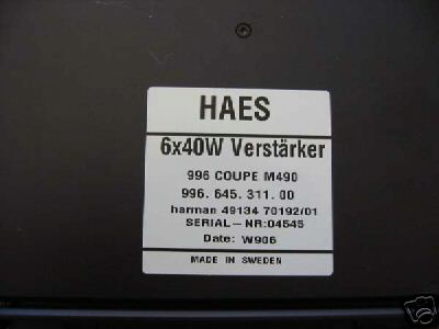

I have been looking on ebay for a 6X40 watt M490 996 amp, as I might put rear speakers in my 1997 Box.
What I have noticed from the ebay pictures is that there is a cabrio and coupe amp. I know nothing about amps or 996s, except that a 996 cab is a fat Box. :D
I would assume I need a 996 cab amp, but I see more coupe amps.
Any of you audio people know if it makes any difference to get a 6X40 amp from a coupe vs. a cab?
Either the coupe or a cab one will work. What's important is the pin connection (which you'll be able to tell if they are the same by picture - some earlier Nokia amps and Bose amps had tiny pins). More importantly is if it's a M490 or M680. With your '97, you'll want the M490 6x40 amp. Otherwise, you'll also need the M680 control panel for your center consol. The M680 was the DSP option and would also require running an add'l harness into the cockpit to control the bass, etc. aside from the stereo functions, etc. Good luck and I wouldn't pay over $100. Otherwise, you'd be better off just getting and aftermarket 6x amp so you can get full sound from your door speakers too.

My January 1997 has a Nokia amp. But I have seen Haes and Harman amps. I always thought Porsche simply had more than one supplier, or you got one brand for a Finland car and another brand for a German car.
I would not pay more than $30 for a crappy Porsche amp. :D But I do want the OEM look.
I will ask Peter if he knows why there is a coupe and cab amp. This question was sort of asked here. http://www.renntech.org/forums/index.php?showtopic=3389
