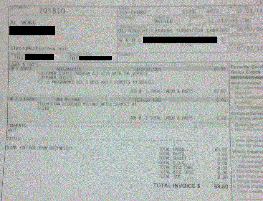

I just recently (Last week of June 2013) had 2 keys made from the valet key. Here is what i did...
Took picture of my valet key and emailed to keysinthepost.com (found them on ebay, yes they are in the UK). For 28.00, I received 2 metal key blades cut to fit my car (tested and it turns door and ignition locks).
Contacted Tysons Porsche (in Vienna Virginia) and was quoted $225 per key fob and $89 for each blade cut for my car and $130.00 service to get them programmed., I requested the part number for the fobs as they claim there could have been different key fobs for the car.
Then I searched the part number on ebay and purchased 2 new fobs (130.00 each in the original Porsche baggie with tags) for 260.00. shipped to my mail box in less than a week.
Took both fobs with my precut blades installed in the fobs to Tysons Porsche for programming. Tysons Porsche only charged me 1/2 an hour (65.00) to program both keys, not the full hour the parts guy thought. And they vaccummed out the inside of my car! I bet they would have washed it had it not been raining!
Total damages - $ 353 ($28 for 2 precut blades, 260.00 for 2 fobs, and 65.00 for programming) for 2 completely functioning key
Total time - just a bit over 1 week.
