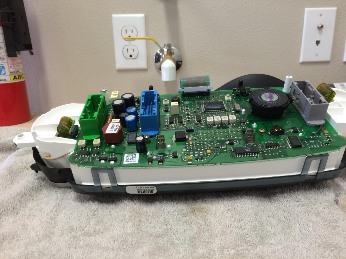

I have read all the threads here on how to access and  replace the instrument bulbs, but I may have a different cluster. My car is a 2003 and the instrument cluster looks different inside from photos posted here.
My cruise control doesn't work (no green light when button is depressed), so I am hoping it is the bulb. I understand if the bulb is bad (open circuit) the system won't operate.
In the attached pictures, do I have to remove the circuit board to get to the bulbs? I believe the cruise control light is behind the speedo? How do I get to the bulb?
I don't want to go much further, as there are a number of ribbon cables that would have to be removed.
Thanks!
Thanks, but I have the newer cluster, and it appears the bulbs are soldered onto the pcb motherboard. I guess if there is a bad bulb, you have to replace the instrument cluster from what I can tell.
I wish mine was the older style cluster.
Maybe Loren might know if my assumption is correct?

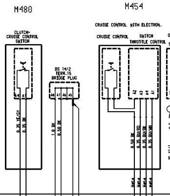

If you have access to a PST2 or PIWIS that might help diagnose.
I would not replace the cluster without checking the simple stuff first.
start with fuse B7 (15A) -- use ohm meter to verify it out of the circuit.
then the switches - again you can use an ohm meter to verify.

The brake stop lights share the same fuse as the cc, so I would think fuse is ok if I have stop lights. Is clutch/cc switch the red one?
Also, are you saying to ohm-out the cc switch on the stalk? Where is the connector for the cc switch? Anything else to check? Is it possible that the coding is corrupted between the cluster and ecu?
