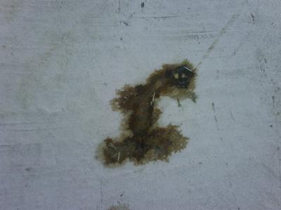

Hello,
I have just purchased a 2002 Boxster 2 weeks ago with 44000 km on it and i am the 3rd owner of the car. Accroding to the local dealer in Toronto (Downtown Porsche), the rear main seal was replaced 14 months ago under warranty and since then, approximately 4000 km were added. Yesterday, I found some drips on the garage floor and I brought the vehicle to Downtown Porsche (same dealer who fixed the RMS 14 moths ago) and the service advisor is suspecting the same problem is returned and advised that "there is no warranty on warranty" and thus, I am on my own. The job will cost approximately $1200 CAD and he said he will try to liaise with Porsche warranty administration and see if the repair cost can be split like 50/50 or 25/75 ..... and he will get back to me in the next 2 days. I have been searching the this forum and other forums and found that Boxster RMS is notouris and seems like Porsche is not taking reaponsibility of this defect or bad design. I am very upset with the situation due to the fact that the repair was done merely 14 mths ago with only 4000 kms added since the repair and the worst part is it seems to be a recurring issue down the orad. In addition, the 48000 km major tune up is due with another $1200 cost is expected...... now, my dream car became a night mare. :(

After 2 days driven on the last weekend, the car has been sitting in the garage since Sunday night and until this afternoon (Wednesday), I don't see any drip on the garage floor at all. Do you think the drips prior could be some kind of "sweat" due to the car hasn't be driven for a while (the car was sitting in the garage for 2 weeks after I brought it home till last weekend) ?
Steven
Edited by ssflai
RMS can stop leaking after stand still for a few days ( leak above oil level ) intermediate shaft seal leak in contrary stays leaking ( leak under oil level ) In your case, i think, that the RMS is the culprit.
